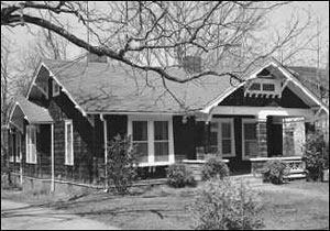

Gables are indispensable to many house designs, but wide overhangs (desirable for both aesthetics and shading) are real wind catchers. One answer is to support the overhang with struts — a characteristic of the bungalow style. In high-wind zones, the attachment of the strut to the wall and the roof edge should be reinforced with steel hardware.

Projecting elements without columns, such as canopies and wide roof overhangs, need similar treatment for the roofing, deck, and framing. The load can be carried back to the building in two ways: with struts or as a cantilever. Struts anchored top and bottom are always the best solution. Make struts as long as possible to minimize loads, and engineer both top and bottom connections. Without struts, the structural members must cantilever. Don’t guess at the cantilever design — use the expertise of a structural engineer. Cantilevers are most highly stressed where they penetrate the building envelope, so good flashing and waterproofing are essential. Unfortunately, it is difficult to flash and seal a cantilevered wood beam, because there is no vertical step to resist horizontal water penetration, and the beam moves a lot when it is loaded. Steel can be very useful in cantilever design.

Gabled roofs are known to fail in hurricanes when compared with hipped roofs, but they are indispensable for most designers. Figure 3 shows a “clipped gable” (also called a “snub-nosed gable”), where the highly stressed gable peak is eased off with a small hip. Such roofs (when built with desirable short rake overhangs) are found in early 20th-century Tudor revival designs and in southern colonial churches, neither of which are commonly found in high-wind zones. Much more common are bungalow designs with clipped gables, but they have undesirable long and thin roof overhangs. Struts under the eaves are also authentic to the bungalow style (see photo, page 7), and may be necessary in high-wind zones.
