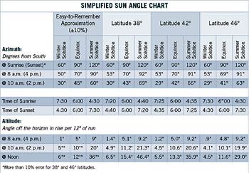

The chart in Figure 1 defines where the sun is at various latitudes (from 38° to 46° north) at various times of day on key dates. To apply this information at the site, you need two things: a compass and a way of figuring angles from the horizon.
Figure 1. Designing with the sun in mind begins with predicting the path of the sun across the site and over the house. Using this data, a designer can chart the sun's path and angle from the horizon (see Figure 3, page 2), providing specific details about the dimensions and positions of shading walls, overhangs, porches, and windows.
Because the sun tracks true north, rather than compass north, you want to use true north for your figuring. To find true north, you need to know the local magnetic declination — how far off true north a compass needle is in your part of the country. In Boston, for example, true north is 16° to the right of compass north. In Miami, it lies 3° to the right of the compass needle. The chart in Figure 2 shows the magnetic variation for a few cities along the Gulf and East Coasts.

Figure 3. To find the sun's location, you need both the azimuth (the angle from true south) and the altitude (the angle off the horizon). The chart in Figure 1 gives altitudes as rise for 12 inches of run, like a roof slope.
To find the altitude of the noon sun at the solstices, you add or subtract 23.5° (the tilt of the Earth) from the equinox position. For Boston, it comes to 24° in winter and 71° in summer; for Miami, 40.75° in winter and 87.75° in summer. Instead of showing these altitude angles, the chart (Figure 1, page 1) shows something you can more easily use in the field: the rise for 12 inches of run. Another way to think of this is the height of a stick that casts a 12-inch shadow with the sun at that altitude. On site, you'd measure this by holding a stick at arm's length, adjusted so you can sight the appropriate rise and run. Approximations are fine.
