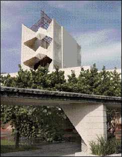

But as sometimes happens with art, Wright’s unique system of grooved block and rebar composing a dozen buildings at Florida Southern College in Lakeland, Fla., has proved more aesthetic than practical. A half-century after they were finished, the nation’s largest single collection of Wright-designed buildings is crumbling.
Lesson for architects: A stellar design, such as Frank Lloyd Wright’s for a series of buildings at Florida Southern College, must still contend with practical reality. In this case, the harsh Florida climate has taken a toll out of the elaborate masonry, requiring the down-to-earth attentions of mason Ken Uracius.
