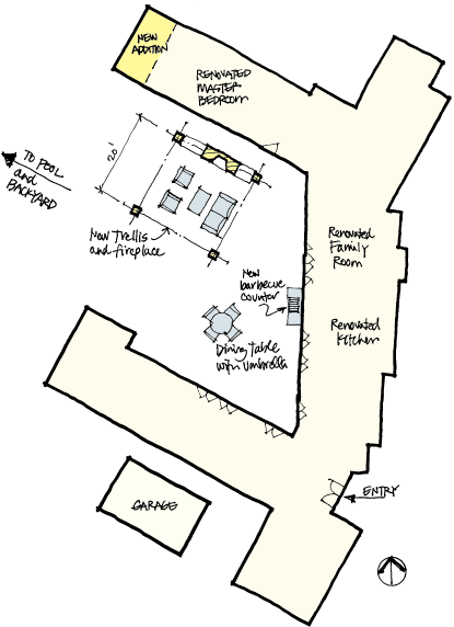

A plan view of the trellis project shows the relationship between the outdoor space and the renovated interior rooms. The small addition at upper left contains an indoor bathroom for the master suite and a smaller outdoor bathroom that’s conveniently near the pool and sitting area.

A trellis “ceiling” over this outdoor sitting space gives the area around the outdoor fireplace the feel of an open-air room. The trellis was assembled from unpainted steel tubing to eliminate the need for intermediate supports; corner supports are reinforced concrete block faced with stucco.
