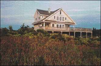

My interpretation. My design (Figure 4) extends a porch around two sides of the small house, with an arcade of wooden posts supporting the outer edge of the porch. The wide eaves of the gable roof come down as low as possible, imitating the horizontal lines of the porch. The effect is an extended base topped by a massive, floating roof. Thus, the height of the house, extending right up to the 35-foot height limit, is disguised: It looks like an ordinary two-story house sitting on the ground.
Figure 4. Tully Design. The low, wide eaves of the Tully design — reminiscent of the Fortier house — work with the extended porch to disguise the true height of the building.
