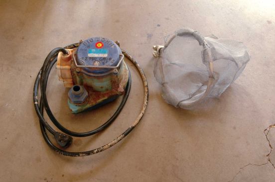

Pumps. A trash pump (also called a sewage pump) is the best choice for removing a lot of “chunky” water in a hurry. A large gas-engine unit can work without electricity (utility power can take days to be restored) and can handle mud, sludge, and other solids with ease. A friend related to me how a small rock that had been sucked into his crawlspace sump pump had stopped it dead. If he hadn’t crawled through the water to clean it out, it would have meant a devastated ground floor rather than just puddles in his crawlspace. (He was also lucky that the power stayed on in his neighborhood).
Unless you have your own pump, however, during a disaster you may be stuck using whatever type of pump you can get your hands on. By the second full day of rain in Boulder, the rental yards and area stores were cleaned out of pumps of all sorts.

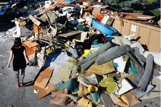

Flooding creates countless tons of waste. In Boulder and other flooded towns, if an affected building was not wiped out completely, the floodwaters still turned building materials, furnishings, and treasured possessions into hazardous waste overnight. Warm weather and wet conditions made every pile of trash a moldy health risk that had to be taken care of as quickly as possible. Since the normal waste stream was instantly overwhelmed, the city and county governments stepped in to help clean up the area, providing three different forms of aid to residents: roll-off containers that were hauled off and replaced a couple of times a day;free drop-off at commercial waste transfer stations, limited to storm-damaged materials from a specific city or county; and free curbside pickup, which was instituted after it became clear that many residents had no plans to dispose of the thousands of refuse piles that sat in driveways, yards, and alleys for weeks after the flooding. This service was also limited to residential waste; commercial buildings and multifamily apartments and condos with centralized trash pickup were excluded.
If you use a sump pump, create an external intake filter by setting the pump inside a 5-gallon bucket with lots of small holes drilled in it; even better, wrap the pump in a piece of screen or hardware cloth. I prefer to use screen because the pump can sit closer to the floor or even be set down into the floor drain opening. You may still need to clear debris from such homemade filters when they get clogged, but they will protect the pump from being damaged.
Remember, you are fighting gravity and friction while pumping, so use the fattest, shortest hose you can. Avoid sharp bends and kinks in the hose and don’t lift the water any higher than you have to. Be sure to situate the outlet end of the hose well downhill of the building—water pumped out into the yard may find its way through the saturated soil and end up back in the house.
Many portable submersible sump pumps cycle on and off via a pressure switch, so they won’t turn on unless they are under several inches of water. This can be a problem once the water is just a few inches deep. With a float switch, though, you may be able to pump all but about one inch of water. Float switches are easy to rig manually because the external floats can be wired or taped into an “on” position—but be careful not to burn out the pump by running it dry.

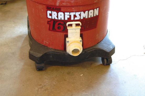

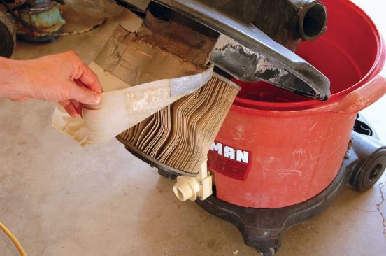

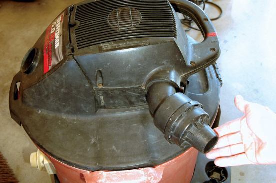

Wet Vacs. Regardless of the type of pump you use, you will be left with lots of water on the floor. At that point, you can either bail the remaining water into a bucket with the pump in it, or switch to a wet vac. Wet vacs are very efficient at sucking up water and sludge, and the bigger the vac, the better. When it comes to this kind of work, I rely on a big, inexpensive vac with a large-diameter hose. It works fast and holds a lot of water, and the filter is relatively cheap to replace after extra-dirty jobs like this. I know these vacs can be used with the filter off for wet use, but I prefer to leave it on to protect the motor from excess moisture and nasty contaminants.
As with the pump, use the shortest hose you have and avoid loops or low spots in the hose that will act as a trap. Prop a flat nozzle about 1/4 inch off the floor in a corner or at the lowest spot in the floor, and use a large push broom or floor squeegee to direct the remaining water to the vac.
My vac has a float ball to block off the suction when the vac is full of liquid, and you can tell when the ball seals because the motor sound changes to a high-pitched whine. Some fancier vacs shut off via an electric circuit that the water closes. Just be sure you know when your vac is full of water; otherwise, you will find out when you hear a loud pop and see a puff of smoke, and all the lights go out.
Full of water, my 16-gallon vac weighs about 150 pounds. The easiest way to empty it is to drop a pump into the tank for several seconds. On jobs without a pump present, fill the tank only part way and empty it into 5-gallon buckets that you can carry out. Once when clearing a flooded crawlspace, I left the vacuum on the main floor above, rolled it to the doorway when full, and drained it into a bucket through the vac’s drain port.
Be sure to dump the water outdoors, downhill of the house. Dumping the water into the toilet may result in water rising back up the basement floor drain.

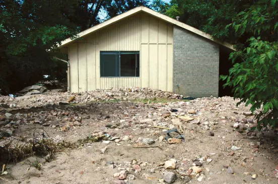

The Value of Sand Bags
We've all seen television footage of people using sandbags to protect buildings against flooding. While it seems futile—the rising water inevitably flows between and over the top of the makeshift barrier—the fact is that, during a flood, half of the benefit provided by placing sand bags around a building comes from the reduction of sediment infiltration.
Until you've seen it firsthand, you may not realize how much damage sand and silt can cause—much more than water alone. Water can be drained and dried out of walls, basements, and crawlspaces, but sediment will fill up every available nook and cranny, clogging drains and ruining electrical devices and gas appliances. And since it contains suspended organic matter and unknown levels of bacteria, you can't count on it to dry into harmless dirt and sand; it has to be removed.
Water may crest a protective wall made of sand bags (or staked-down straw or hay bales), but most of the heavier sediment won't go over the top with the water. So if you have a chance to build even a short barrier wall around property you are trying to protect, it may reduce the damage—and cleanup effort—significantly.

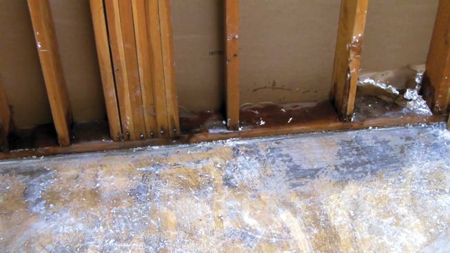

After a flooded basement is pumped and mucked out, all wet and contaminated building materials must be disposed of quickly to restrict the growth of mold and remove the residual moisture from the building. During the week after the flood, I visited a site that was undergoing the second stage of cleanup by groups of volunteers supervised by the local Flatirons chapter of Habitat for Humanity.
Flooring. Soaked carpet and padding should be the first thing to go. Cut it into strips a few feet wide, roll up as much as you can handle, and crosscut the strip. To carry these dripping wet materials upstairs and through finished living space without making a mess, cut the rolls to fit into a bucket or garbage can. For tile and other hard flooring, common sense will dictate what should be removed. If sewage was present in the floodwater, it is probably safer and easier to remove the flooring than to clean it in place. For “clean” floodwater, it depends more on the amount of water damage. Vinyl flooring might be just fine, but hardwood floors probably won’t be worth saving.

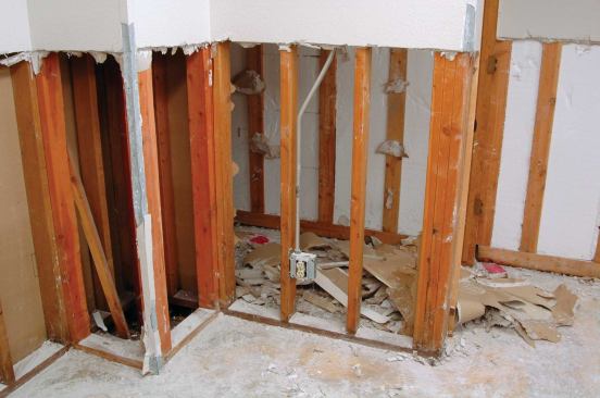

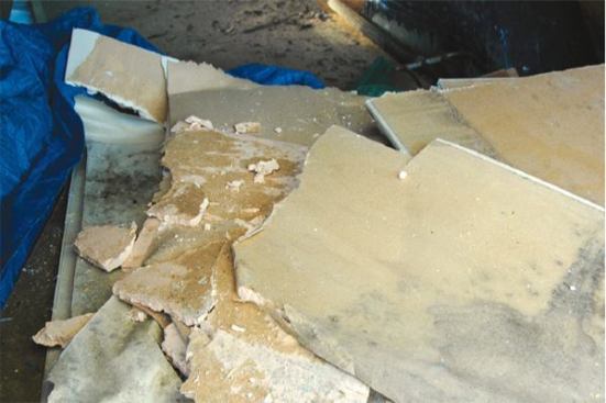

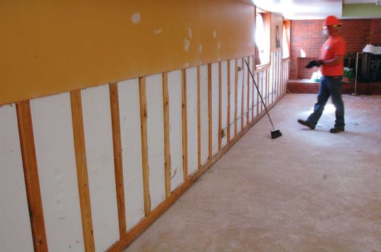

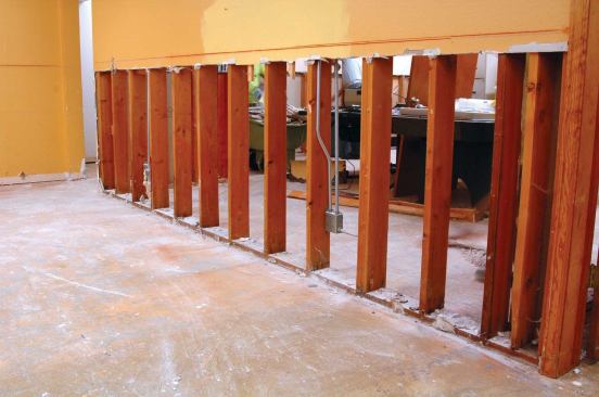

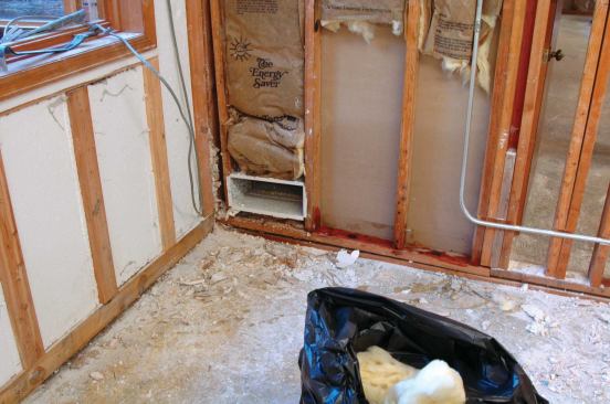

Drywall. For shallow flooding, some people skimp, and remove drywall only to a level that is a few inches above the height of the floodwater. But that means patching and finishing will require workers to bend or work on their knees, adding labor expense. The professional approach (for flooding less than 4 feet deep) is to deeply score the existing drywall 48 inches above its bottom with a utility knife and pry it off the wall from the bottom up.
Wood. Studs and furring strips are often left in place to dry out. As long as the wood is sound, it should be okay. Floor plates, furring strips, and any other wood in direct contact with concrete will hold moisture for a long time and should be chemically treated to suppress mold growth and allowed to dry.
Insulation. Fiberglass insulation that has been saturated should be cut out and discarded. Less-porous foam insulation is often left in place to dry out, but not in all cases. Closed-cell and open-cell foams offer no food for mold, but they can hold moisture in for a long time, so make sure any wood that is in direct contact with foam is dried and treated. For the same reason, concrete walls behind foam insulation should be given enough time to dry thoroughly before drywall is hung over the insulation. Generally, this will require removing the foam, then replacing it after the concrete has had time to dry.

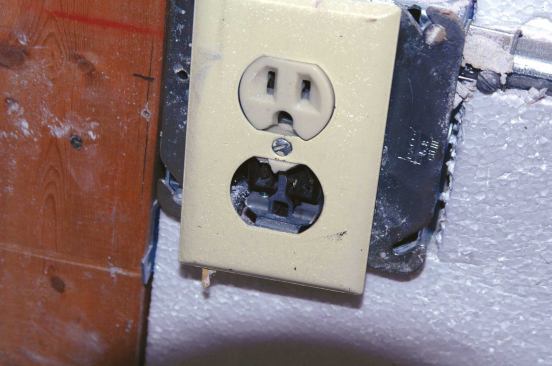

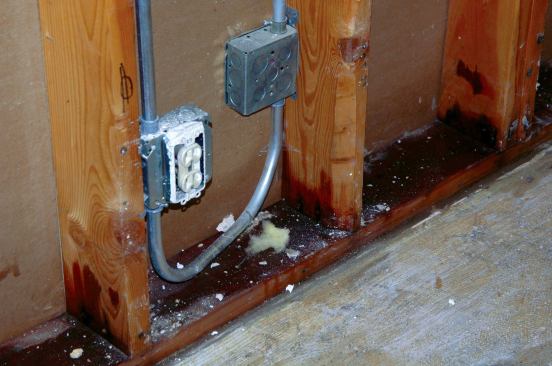

Electrical wiring. Romex-type nonmetallic cable and plastic boxes should be okay to leave in place, but conduit and armored cable can hold water inside, which presents a danger. Do not use these circuits without inspecting for soaked wiring and consulting an electrician. Also, don’t trust any electrical device that has been underwater. Flooded receptacles and switches should be replaced. Even if they dry out completely, sediment or other fine debris from the flood water that washed into a device could lead to insufficient contact or shorting.
While I was at the Habitat site, a volunteer using a shop vac illustrated the seriousness of this danger pretty effectively and got a good scare in the process. After running the vac for a minute or so plugged into a receptacle wired through conduit, the device exploded with a flash that lit up the room like lightning. The plastic face of the receptacle was incinerated, leaving bare metal contacts visible. I’m not sure if it shorted out due to water in the device or in the conduit, but it made clear the point about not using flooded devices.

None of the available disposal options could take landfill-prohibited items, however, which were handled as follows:
  • Separate roll-off containers were provided by local waste disposal and recycling facilities for recyclable metals, including most appliances (except those containing refrigerants). Some organic materials, such as yard and food waste, were also commercially composted rather than hauled from remote areas to the landfill.
  • Paints, automotive fluids, and other chemicals had to be taken to a hazardous waste disposal facility.
  • Electronics and appliances containing refrigerants had to be taken to a designated drop-off facility, which also accepted other recyclable materials, such as plastic and rigid foams.
  • “Dirty” dirt—mud, silt, and sand contaminated with chemicals and sewage—had to be landfilled. Only sediment from streams that was deposited away from buildings was reused as fill.
Asbestos and lead paint. Information on debris containing asbestos or lead paint was contradictory. A county website said that if asbestos was not known to be present in a building, you could treat waste material as non-asbestos flood debris. But a state website outlined more stringent guidelines. The same was true for lead paint. No guidelines or warnings were posted regarding the handling and disposal of lead paint debris in a disaster area, so it was not clear if RRP rules had to be followed during cleanup.
No contractors allowed. None of the disposal services provided could be used by contractors. Even though the services were paid for with public funds, a resident could not hire a hauler to transport debris to a public container site and expect to have tipping fees waived. Similarly, any flood sediment deposited on the street by a contractor was ineligible for city-funded curbside pickup. Showing a building permit proving that the waste came from a home within the disaster area would not serve to waive the fees. According to the Boulder County Resource Conservation Division, this rule was designed to protect the homeowners, who would be charged a tipping fee by contractors either way. Only having the homeowner with you in the truck at the time of drop-off would serve as enough proof that what you were hauling was from a legitimate site.
The lesson here for contractors is to charge clients full price for hauling and disposal—and not to expect to take advantage of any disaster services or programs intended to help clean up the damaged properties in an affected area. And the lesson for homeowners is that as soon as they hire a professional to help them, they lose any publicly-subsidized services and benefits provided to citizens in an area affected by a disaster.

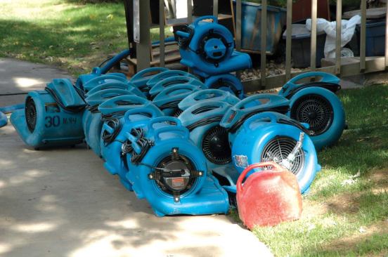

Once everything is cleaned, the final step is to dry out the space. If you are renting equipment, keep in mind that the experts around here told me they typically have to keep their machines running for three to five days. If you live in a more humid area or if cold weather sets in, it may take longer to dry things out. The large tool-rental chain in Boulder said they brought in five semi trailers with more than one thousand pieces of drying equipment right after the flood—and it was all put into service right away. The demand for machines was in the following order:
  • Dehumidifiers. These are the most effective tools for drying out a building because they actively condense moisture out of the air. Large, high-capacity mobile units dry air more quickly than household units do. In regions with high ambient humidity, during the heating season, and in spaces without ample ventilation (like basements and crawlspaces), a dehumidifier is essential for drying a building.
  • Air movers. Also called carpet driers or carpet fans, these distinctly-shaped fans blast a high volume of air along the floor to promote evaporation. They are typically used in conjunction with dehumidifiers: The powerful stream of air pulls the moisture out of materials at the surface, and the dehumidifier draws the moisture out of the air. During warm weather in relatively dry areas like Boulder, air movers and other fans may be enough to dry out a space as long as there is good ventilation with fresh air at low humidity.
