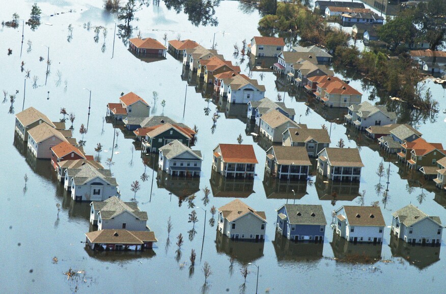

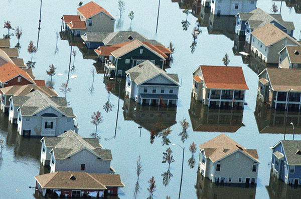

Strategies for rendering homes resilient to floods vary by whether the site is subject to coastal wave action or (in the case of most inland flooding) at risk of immersion in still or slow-moving high water.

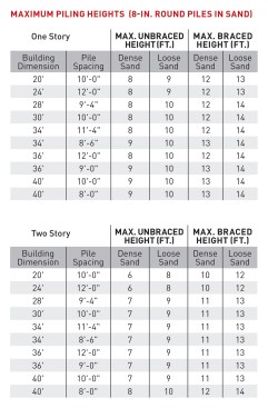

The height of the foundation is only one factor in coastal-storm resilience. A building’s structural integrity also depends on the depth of piling embedment and the quality of connections between the piling and the framing.
Example piling heights based on Texas Dept. of Insurance Building Code for Windstorm Resistant Construction.

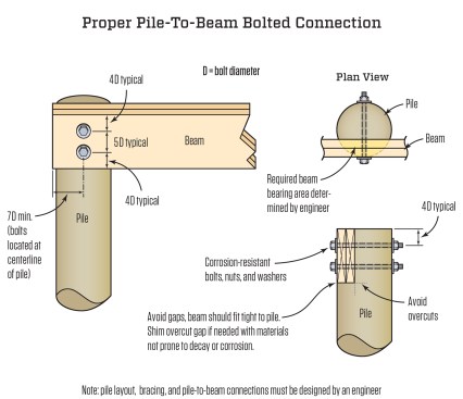

Girder connections. When a piling foundation fails in a storm, it’s usually because the connection at the top of the piling fails, which causes the house to wash off the foundation. A strong connection between piling and girder requires a notch in the piling and several galvanized 3/4- or 7/8-inch-diameter steel bolts. Although it might seem easier to simply cut the tops of the pilings flat and use metal straps to secure the girders, that is more complicated to do well and ultimately takes more time.
The notch for a piling-to-girder connection should not be deeper than half the cross section of the pile. As with the overall structural design, the connections must be specified by an engineer for V-zone foundations.
Piling connection details adapted from FEMA P-499 (Dec. 2010): “Home Builder’s Guide to Coastal Construction”

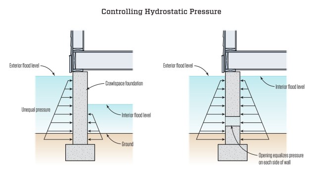

Solid foundations are the norm in most inland flood areas, and while they may not see the intense force of waves, they can see lateral hydrostatic loads from standing or slowly moving floodwaters. If the water level on one side of a foundation wall is much higher than on the other, the wall must resist an immense load. The answer for many crawlspace walls in flood-prone areas is to install flood vents, which are designed to open under hydrostatic pressure. The flow of water inside equalizes the pressure on each side of the wall, providing relief.
If the water level on one side of a foundation wall is much higher than on the other, the wall must resist an immense load. The answer for many crawlspace walls in flood-prone areas is to install flood vents, which are designed to open under hydrostatic pressure. [Illustration adapted from Building Science Corp. BSI-128]

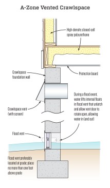

For vented crawlspaces, most building codes require air vents sized at least 1 square foot of net free area for each 150 square feet of crawlspace area. NFIP prescriptive requirements for flood vents call for at least 1 square inch of net free area for every square foot of crawlspace area, with two vents per enclosed area on different exterior walls. The required flood vent sizing is slightly more than the air-ventilation requirement—a detail to note when non-engineered flood vents double as air vents in a short crawlspace.
The wall in the upper portion of the wall is for ventilation air, as required by code. The vent lower on the wall- (preferably at grade) is designed to open under hydrostatic pressure to prevent the wall from toppling.  [Illustration adapted from Building Science Corp. BSI-128]
For tall crawlspaces in areas with a high BFE, the best solution we have seen is to provide flood vents lower down (codes specify placing all flood vents not more than 1 foot above grade) and position required air vents high on the wall for increased circulation. (For more on building a tall crawlspace, see “Rebuilding a Flooded House” by Dave Yelovich, Nov/18.)

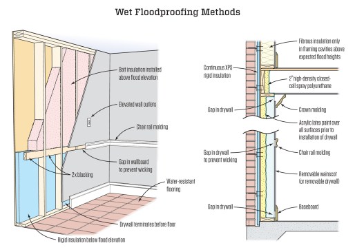

When it is impractical to elevate buildings, the lower, flood-prone areas of the building can be built or retrofit with materials that will withstand getting soaked once they dry out. [Illustration adapted from LSU AgCenter (left) and Building Science Corp (right)]
Illustration adapted from LSU AgCenter (left) and Building Science Corp (right).
The goal in both cases is drainable and dryable building assemblies, using building materials that don’t fall apart when they get soaked and that can be easily cleaned and dried after a flood. For example, ordinary drywall is replaced with painted wood or cementitious panels, and fiberglass batts or cellulose cavity insulation is replaced with closed-cell spray foam and rigid insulation boards. Electrical fixtures and wiring also get destroyed when immersed in water, and the paper insulation in Romex wicks water far up the lines. To reduce the chances of this happening in a flood, outlets need to be placed higher on the wall.
Floodwaters tend to be filthy, so the interior side of the wall should be designed to be opened up, scrubbed, rinsed, and disinfected. In any flood, the extent of the damage and the demolition required will vary depending on how deep the floodwater is, how dirty it is, and how long this water sits in the house. In some cases, the interior wallboard may have to be completely stripped out. In others, only the lower wall may need gutting. In a best-case scenario, homeowners might be able to just remove strips of material and flush out and dry the walls.

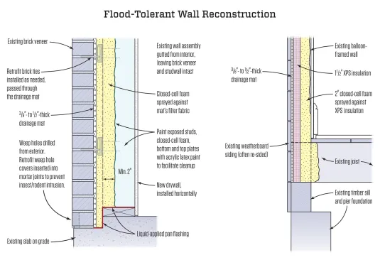

Reconstruction after a flood will vary depending on the type of construction. For example, the solution shown below left was developed by Lstiburek to help rebuilding efforts following Hurricane Harvey in Houston, where brick veneer exteriors and slab foundations are common. This assembly creates a drainage and drying gap behind the brick, outboard of the insulated wall, using an open-weave or dimpled drainage mat against the brick. The base of the wall is coated with fluid-applied flashing to create a drain pan at the bottom of the wall. Weep holes in the bottom course of brick allow water to exit the cavity.
Paul LaGrange, a Louisiana-based building-science consultant, and JLC contributor Bill Robinson adapted the Lstiburek techniques to retrofit homes flooded during Hurricane Katrina in 2005, and in the Baton Rouge floods in 2016, where rebuilding efforts are still taking place. Some of the New Orleans homes were listed as historic properties, and on these balloon-framed homes, it often wasn’t feasible for crews to remove the existing “weatherboard” siding, so, as with the brick-clad Houston homes, crews worked from the inside to create robust air and thermal barriers and a drainage plane.
As shown below right, LaGrange took a cue from Lstiburek’s Houston design: He placed a drainage mat against the board siding, cut and fit sheets of XPS foam board, then applied closed-cell spray foam to air-seal the wall and lock the components together.
In both the Houston and Louisiana designs, the approach is the same: Building details employ materials that are not sensitive to water to reduce damage and make cleanup and repair easier the next time the building is hit by a flood. The centermost insulation layer is watertight and impermeable, while materials toward the inside and outside faces of the wall allow for drying.
Two methods for retrofitting spray-foam insulation, which can withstand wetting, in the first-floor walls of older, existing buildings. [Left-hand design based on information from Joe Lstiburek, Building Science Corp., right-hand retrofit based on information from Paul LaGrange.]
