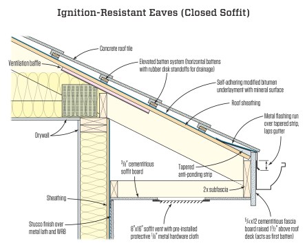

    Click to enlarge
    In a big wildfire, strong winds may carry hot embers or even large flaming firebrands for long distances. Embers can be sucked into soffit vents or land in gutters, where accumulated pine needles or leaves may catch fire. The detail at left reduces these risks; the soffit and fascia are noncombustible fiber cement, the roof is concrete tile, and metal flashing laps down into the metal gutter. The rough bottom surface of the tile allows moisture to weep out but restricts the entry of flame and embers.

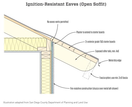

    Click to enlarge
    In open-eaves construction, blown embers can accumulate between blocking and rafter tails and may be sucked directly into the roof assembly through soffit vents in the blocking. For this reason, some Western municipalities have adopted Wildland Urban Interface (WUI) codes that call for unvented roof assemblies and thicker than usual solid-wood rafter tails on the exposed underside of roof eaves. Solid wood is less likely to be ignited by embers and is more likely to char over if does catch fire.
