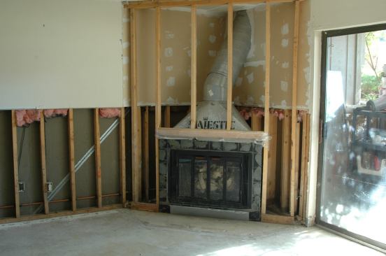

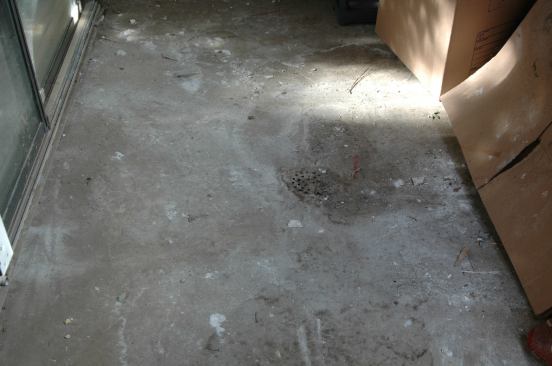

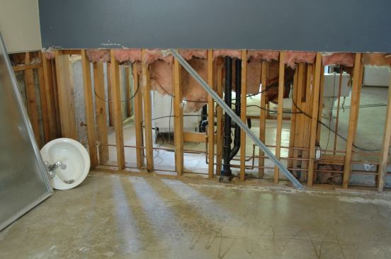

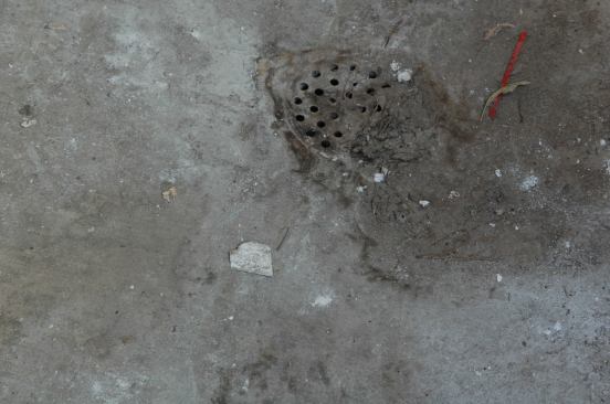

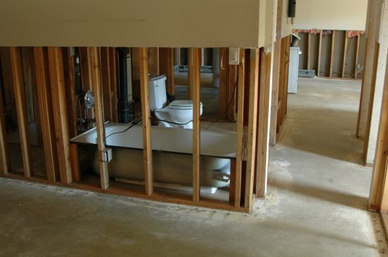

Before a space is dried out, it needs to be cleaned well. A clean-up contractor I interviewed uses a pressure washer on walls and floors for any category 2 or 3 clean ups–it’s a lot easier than trying to scrub every nook and cranny of furring strips, wall studs, radiators, etc.. The wash and rinse water is collected by a large truck-mounted water extractor similar to a carpet cleaning extractor. Strong broad-spectrum anti-microbial cleansers are used at this stage in a flood clean up. Besides cleaning any scum and contaminants left behind by floodwater, backed up sewage, or both; the proper cleaning products used for this work disinfect and sanitize surfaces. One major benefit of anti-microbial disinfectants over bleach is that they don’t have to be rinsed and therefore can provide lasting bacteriostatic and fungistatic protection. After wet cleaning, a second application of disinfectant is usually applied to affected surfaces to sanitize them

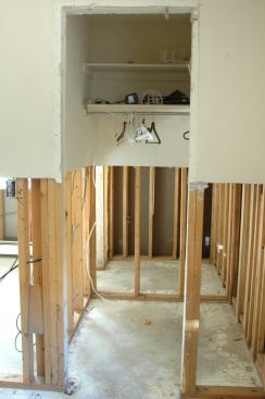

Drying Out

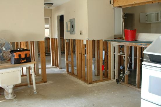

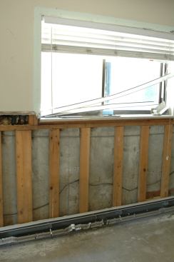

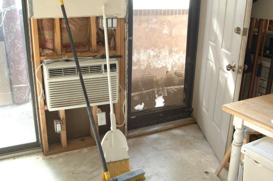

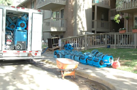

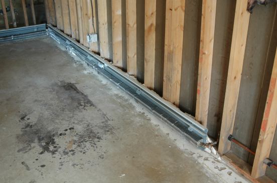

Once everything is cleaned, you will need to set up equipment to dry out a space. If you are renting, keep in mind that the experts around here say they typically have to keep the machines running for three to five days. If you live in a more humid area or if it is cold out, it may take longer. The large tool rental chain in town said they brought in five semi trailers with over one thousand pieces of drying equipment right after the flood and that it all got put into service right away. The demand for machines was in the following order.
Dehumidifiers are the most effective tool for drying out a building because they actively condense moisture from the air. Large, high capacity mobile units dry air more quickly than household units to better help you stay ahead of mold. In regions with high ambient humidity, for spaces without ample ventilation like basements and crawlspaces, and during heating season, a dehumidifier is probably a necessity for drying a building.

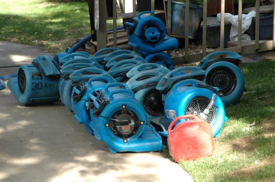

Air Movers — also called carpet driers or carpet fans–blast a high volume of air along the floor to hasten evaporation. They are typically used in conjunction with dehumidifiers; the powerful stream of air pulls the moisture out of materials at the surface, and the dehumidifier draws the moisture out of the air. During times of warm weather in relatively dry areas like Boulder, air movers and other fans may be enough to dry out a space as long as there is good ventilation with fresh air at a lower humidity level
Air Scrubbers are recirculating fans that have a series of three or four filters to clean particulates out of the air. The third filter is a HEPA filter which can trap fine mold spores, and the optional fourth filter contains activated charcoal to absorb odors.

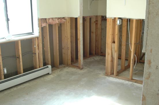

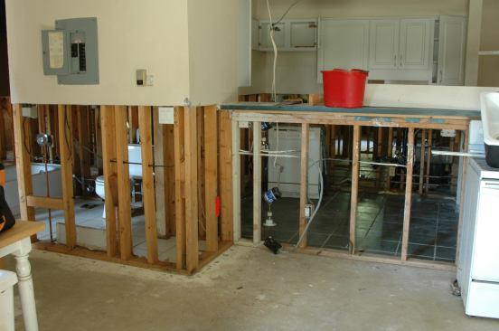

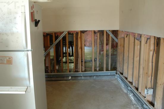

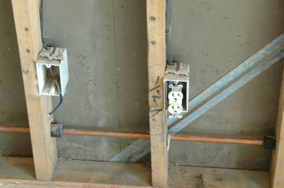

While the building is drying out, spot moisture meters are used to monitor the moisture content of the wood that was wet. Sample readings should be taken all over, but it’s especially important to check where the wood stayed wet the longest and dries the slowest such as stud wall plates sitting on concrete. Some clean-up contractors prefer using moisture meters with probe pins while others prefer the non-intrusive scanning type. There are also two methods for determining when a building is dry. One company I interviewed said they keep the machines going until every reading they take is at 9% or below. Another company said that their target number is within 4% of readings of known dry areas in the same building, which means drying to between 4% and 11%. Either way, materials in the building need to be brought way below the 17% moisture content that will harbor mold.
