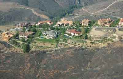

When last October's out-of-control wildfires pushed toward The Bridges, a Lennar Homes luxury development in Rancho Santa Fe, Calif., Lennar manager Key Ayers stayed put. After sending 140 employees home and seeing the community's well-heeled residents safely off, Ayers (who is also president of The Bridges' homeowners association) manned a water truck in the deserted neighborhood. For several hours, he and a handful of workers hosed down the occasional flaming bush or patch of windblown embers.
"I'm not going to tell you it was pleasant, because it wasn't," says Ayers. "The fire was 200 yards away, and it was hot and smoky. But we had good firebreaks [including the community's golf course], and the fire department was here too. And it worked out." When the flames had passed, not one of the development's multimillion-dollar houses had burned. Strict rules governing home siting, construction materials, landscape plantings, and brush clearing had done their job.
The fire district of Rancho Santa Fe lost 61 houses in the fire, and the rest of San Diego County lost hundreds more. But in the five Rancho Santa Fe developments designated "shelter-in-place" communities — including The Bridges — only one house suffered any damage. (In that case, a piece of pegboard leaning against a door caught fire and burned through the door into the garage — but sprinklers in the garage put the fire out in minutes.)
Rancho Santa Fe fire marshal Cliff Hunter says October's events were a true test of the fire-resistant concepts his district has begun to apply. The five successful developments faced the same onrushing wildfire as other areas of town where the destruction was much worse. But because homes were set back from slopes, and vegetative fuel near buildings had been thinned or removed; and because there were no vulnerable vents, windows, or lightly framed wood decks where embers could collect and ignite, fires raging up canyon slopes stopped cold at the edges of all five neighborhoods. According to a press report, a firefighter responded to thanks from residents of one community by saying, "We didn't really do anything."
