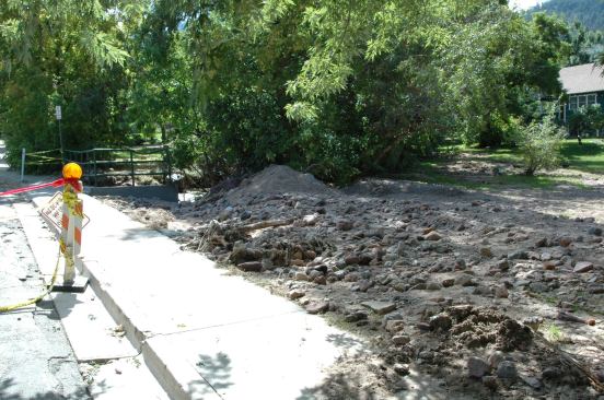

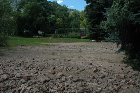

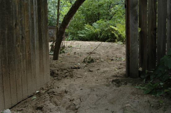

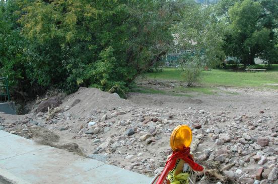

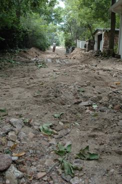

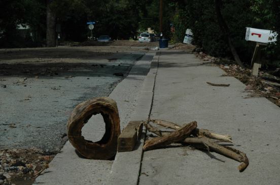

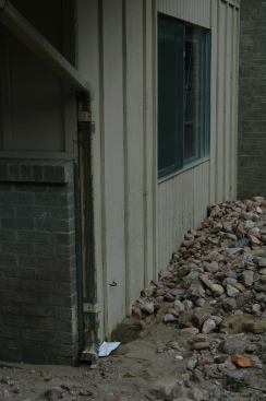

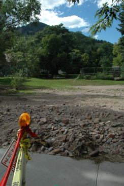

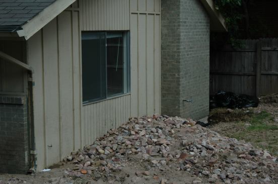

(Boulder County Colo.) Some waste after a rain-induced flood is expected–like damaged building material and ruined belongings from inside homes and businesses–but a surprising amount of waste created in our recent flooding were natural materials that flowed in from the surrounding environment. Mud, silt, and sand sifted into structures and filled every crevice in the landscape while rocks and driftwood piled up in yards and on the streets. It was a surreal scene to find the scoured and battered trunks of pine trees that tumbled down from the mountains onto the city streets miles below.

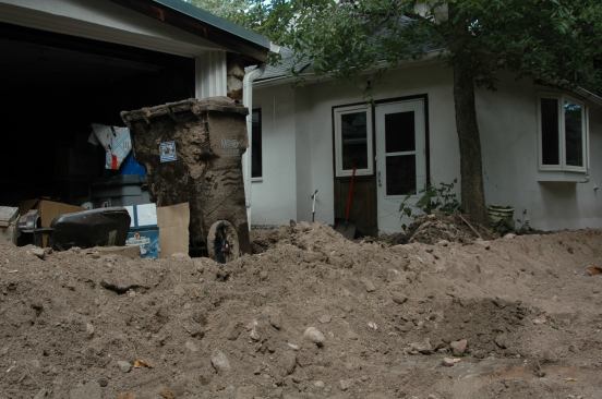

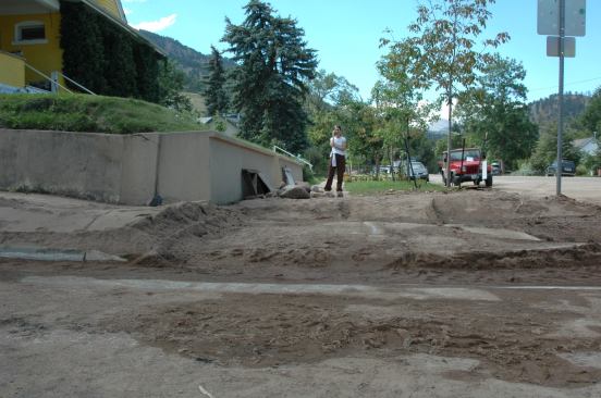

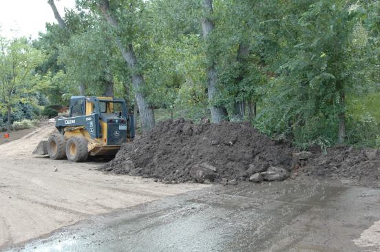

During the City of Boulder’s curbside pickup in the weeks after the flood, seven times more sediment (by weight) was removed than building materials and other trash.

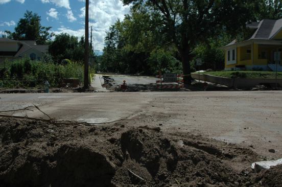

“Dirty” Dirt

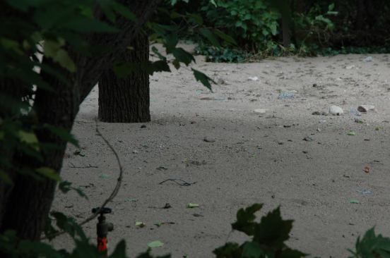

Surprisingly, the earthen mix of mud, silt, and sand picked up throughout the city was not usable as fill. The unknown chemical and sewage content of the combined sediment made it hazardous enough that it all had to be landfilled. However, sediment deposited on bike paths, parks, and other public lands away from houses will be used as fill according to the City of Boulder. The city itself has an estimated 20,000 tons of this sediment to deal with, independent of the tonnage in Boulder County’s other municipalities and unincorporated areas.

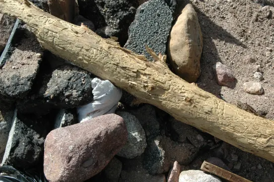

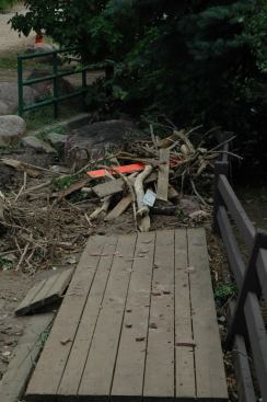

Vegetation Debris

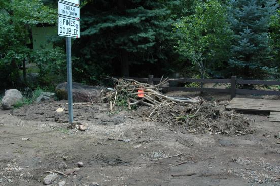

Discarded crops, trees and weeds washed out by flooding, and other related vegetative waste represent another category of debris that must be dealt with after a flood. Here in Boulder County, much of it may be fodder for local commercial composting yards, but matter contaminated with chemicals or heavy metals should be excluded because its toxins will survive the natural decomposition process and be present in the finished compost used in yards and vegetable gardens around the region.
Due to its proximity to the mountains and its greater population density, the City of Boulder took a conservative stance and landfilled the vegetative waste it collected along with the flooded building materials, trash, and sediment. However, organic materials being picked up by the county in mountain communities and unincorporated areas will be commercially composted. In addition, Boulder County residents can take in organic flood-related matter to the yard waste collection center for commercial processing. The fees for this drop-off service will be waived for the foreseeable future as residents gradually clean up their property.

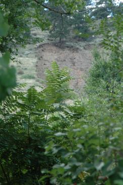

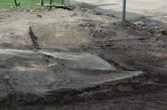

Creeks and rivers brought down so much mud and rock during the storm that they reshaped the landscape in many parts of the county. Some creeks and drainages ended up hundreds of feet away from their original beds in places after the storm and had to be routed back with heavy equipment during the weeks after the flood. These new waterways blocked access to homes, schools, and other buildings that were suddenly on the wrong side of a creek.

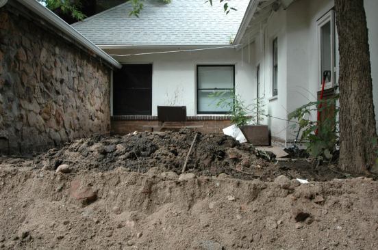

Sediment Damage

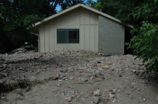

Besides choking out wildlife and its habitat, flood sediment also causes a lot of specific property damage you may not think of until you’ve seen it firsthand. The infiltration of sand and silt into a building can cause a lot more damage than water alone. And since it contains suspended organic matter and unknown levels of bacteria, any sediment washed in should be removed–you can’t count on it to dry into harmless dirt and sand.
Water can be drained and dried out of walls, basements, and crawlspaces, but pervasive sediment will fill up every available nook and cranny while clogging drains and ruining electrical devices and gas appliances. For example, the tubular gas burner in a domestic water heater may be salvageable if it just filled up with water briefly, but if the orifices are clogged with silt, it’s probably toast. The same goes for electric motors and other furnace components.

During a flood–especially in flowing flood event as compared to flooding from rain and rising groundwater–half of the protection provided by placing sand bags around a building is reducing the infiltration of destructive sediment. Water may crest a protective wall made of sand bags (or staked-down straw or hay bales), but much of the heavy sediment won’t go over the top with the water. So it you have a chance to make even a short barrier wall around property you are trying to protect, doing so may reduce the damage you suffer significantly.
