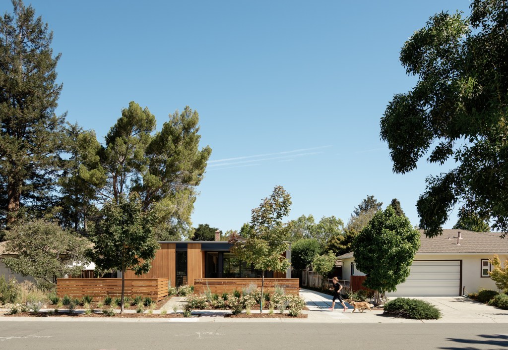

Some of those same techniques making Levy and Stott’s designs affordable, green, and efficient to build also enhance the houses’ fire resistance. Steel-framed modules that snap into standard shipping container-sized frames solve shipping challenges and make the houses nearly fireproof. The firm’s existing homes weathered the most recent round of fires.
“Almost all of our existing clients ended up having fire on or close to their sites—which is kind of terrifying, really—but none of them burned,” says Stott. “Often, an ember blows on the roof and the air draw from an attic starts the fire, but there are no attic spaces in our houses and rarely overhanging eves. Also, we build using steel assembly, so no place for fire to ignite really.”
Joe Fletcher Photography
Other materials used to finish exteriors and interiors also boast nonflammable characteristics. As Stott succinctly puts it, “Modern homes look good in aggressively fireproof materials.”
Connect Homes offers all plans in a metal exterior cladding with a resin-based coating—another difficult to burn material. If a client prefers natural wood instead of—or as an accent—to the metal, Levy and Stott use only spec thick , low-combustible cedar that’s slow to ignite and increases fire resistance. Decks are also made from cedar and rest on the ground, so there’s a lack of flame-feeding airflow beneath them.
Inside, homeowners choose from engineered wood and tile for floors and walls. Countertops are almost exclusively done in quartz. Such smooth finishes, combined with open floor plans, clean lines, and abundant glass fit Levy and Stott’s architectural values. The uncluttered style of design also deters leaping flames.
“We use less trim or connections or complicated shapes,” Stott explains, “so the possibility of embers jumping onto a small piece of molding just doesn’t happen.”
