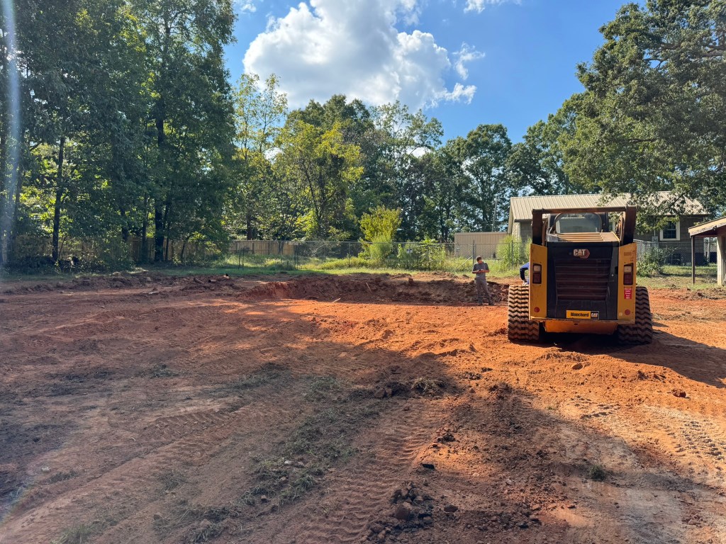

So now, it’s time to clear the site, shape the grade to improve drainage, and get to work on footings and foundations. We’ll be managing runoff with careful grading regardless of the foundation type, and if we go with a crawl space, we’ll also install a perimeter foundation drain and waterproof the walls. We’re ready to go. The Abels are ready to go. And this project is about to move from preconstruction to full construction. That’s a milestone worth celebrating.
