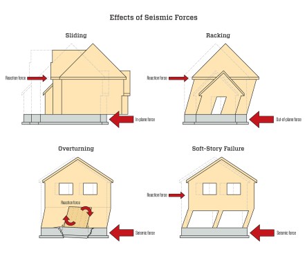

While many of the building elements used to resist earthquake forces are similar to those that resist hurricanes and tornadoes, the forces themselves are generally quite different. In high winds, uplift is the most significant force, whereas the predominant forces from earthquakes are lateral forces that apply horizontal loads. Earthquake waves do impose vertical forces on a building, but its weight often provides resistance to this load. A building’s weight also contributes to its response to the strong lateral force: As the ground shifts sideways (a force known as “ground acceleration”), the inertia of gravity delays movement in the upper parts of the house. By the time the upper parts move (the degree of deflection here is called “drift”), the ground is shifting in the other direction.
If we break down this force on just one wall, the lateral forces act both parallel and perpendicular to that wall plane:
In-plane forces acting parallel to the wall threaten to shear foundation-to-wall anchors and cause the building to slide off its foundation if those anchors fail. Partial failure of the anchor bolts can impose uplift forces on one side of the wall section and cause walls to overturn. In-plane forces acting on a wood-framed wall are resisted by “shear nailing”—the nails attaching wall sheathing to the top plate, studs, and sill—and by the anchor bolts attaching the sill to the foundation.

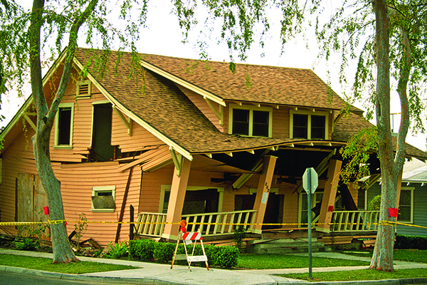

Out-of-plane forces act perpendicular to the wall and can cause the same wall to tilt forward and backward, and this motion can force the perpendicular walls to rack out of plumb. Partial failure of shear components can result in rotation of floor and roof diaphragms (torsion). And racking in the walls of a lower story (a “soft story”) with a significant dead load over it may cause the building to collapse entirely. Out-of-plane forces are resisted by connections between the wall’s top plate into floor and roof framing, and at the bottom by anchor bolts in the sill plate.
Click to enlarge
In an earthquake, the ground accelerates horizontally, both back-and-forth and side-to-side. When the force is parallel to a wall (in-plane loading), it can cause that wall to slide off its foundation. When applied perpendicular to the same wall (out-of-plane loading), it causes the top to drift, in turn causing the meeting walls to rack. Partial resistance by building elements to these forces can transfer the horizontal force into rotational forces that can topple walls, pull-out hold-downs, and destroy unreinforced masonry. Large openings in a lower story with a large gravity load overhead are especially vulnerable to racking and collapse.

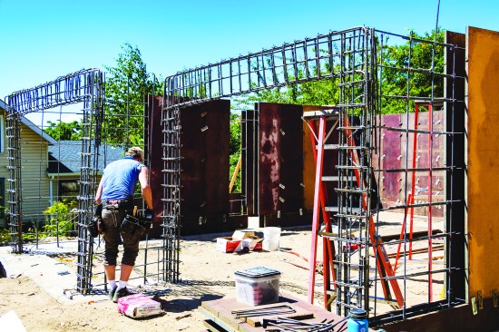

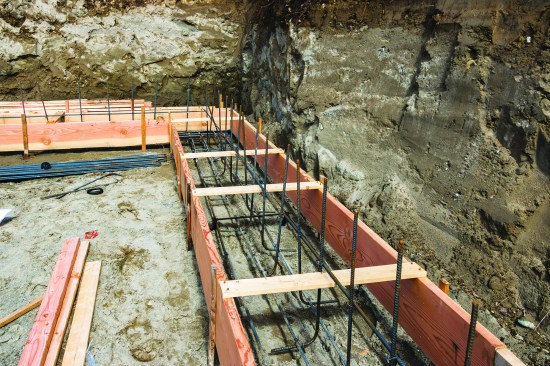

Reinforced foundations. Foundations primarily support gravity loads, but in a seismic zone, they are called on to resist significant horizontal loads, as well as greater uplift on anchors that prevent shear walls from racking and overturning. This resistance is accomplished with thicker and wider footings, deeper turned-down slab edges, thicker walls and slabs, and much more and larger reinforcing steel. Common details are vertical rebar tying the footing to the stem walls at close intervals and extended rebar hooks overlapping horizontal rebar at corners and height transitions. (For more, see “A Practical Guide to Building in Seismic Zones” by Tim Uhler, Aug/16)
Seismic-resistant new-construction details may vary according to engineered plans, but most wood-frame buildings include these elements: wider, thicker footings with closely spaced rebar verticals, …

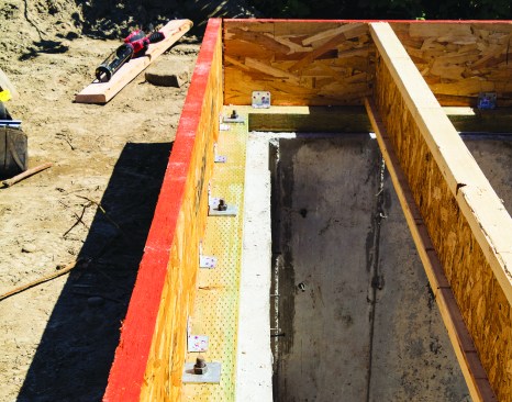

... larger sill anchors and ties to connect the sill and floor framing, …

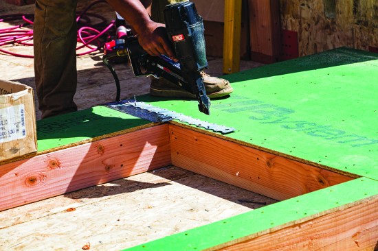

… and strap ties or other connections to complete the load path between floors. (Please note: In the photo above, the author is using a positive-placement nailer to align nails in the strap-tie holes. Don't do this with an ordinary air nailer.)

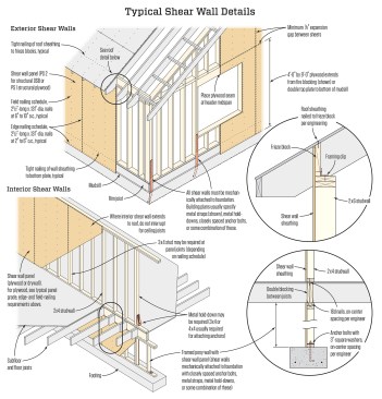

Shear walls. Shear walls are designed to resist the lateral loading caused by ground movement in an earthquake and transfer those loads to the foundation. Engineering plans typically include a shear-wall schedule calling for 15/32-inch CDX (plywood) or 7/16‑inch “APA Rated Sheathing” (OSB). All panel edges that don’t fall on plates must be blocked between studs to accept edge nailing (see “Typical Shear Wall Details,” above). The shear-wall schedule also calls out the attachment of sheathing to framing and the attachment of the wall to the foundation and roof. It’s critically important that panels are gapped 1/8 inch at joints to allow panels to expand and contract without buckling. Longer panels (9 and 10 feet) are often preferred, as they require less blocking in the walls and a lot less edge nailing.
Click to enlarge
In seismic zones, most engineered plans require exterior walls, and often some interior walls, to be framed as shear walls. This is not just continuous sheathing. True shear wall also requires continuous foundation support; hold-downs to tie posts in shear-wall sections to the foundation; and all panel edges secured with tight nailing and supported by blocking or framing. (Illustration updated from "Shear Walls, The Basics" by Tim Uhler, May/20.)
For shear panel to be fastened correctly, it must be nailed off at the correct spacing and the nails set properly. The shear-wall schedule provided by a designer or engineer typically includes nail size and spacing. It will specify both edge nailing and field nailing.
All shear walls must be mechanically attached to the foundation. The plans usually specify metal straps, hold-downs, closely spaced anchor bolts, or some combination.

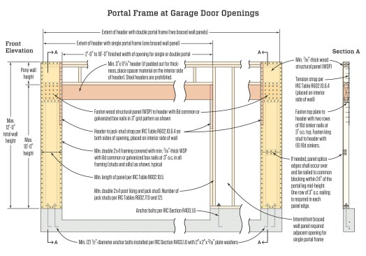

This type of portal frame can be used if the supporting walls are 8 feet tall and at least 24 inches wide (wider for taller walls), and must be bolted to concrete. Other types of wood portal frames are possible (see JLC's “The Portal Frame Option”).

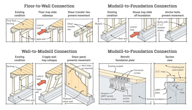

The goal of below-floor retrofitting is to connect a house firmly to the foundation and stiffen cripple walls by turning all or part of them into shear walls so that lateral forces are transferred through them into the foundation. In addition to turning cripple walls into shear walls, most of the focus is on strengthening the floor-to-wall connection to transfer lateral loads to the shear walls, and the sill-to-foundation connections to resist sliding. Overturning is often not an issue with cripple walls because the walls are typically relatively short. Therefore, hold-downs to resist uplift at the ends of shear-wall sections are not often called for.
This work assumes the foundation is adequate to hold anchors, which in some older homes it isn’t. The shear strength of the concrete is not the issue. Even unreinforced, 1,500‑psi concrete will be sufficient against shear (the wood members anchored to it are often weaker), but the old concrete may be too weak or too shallow to hold anchors. In these cases, it may be necessary to pour new footings. But usually, this new concrete can be poured around the old.

A house with cripple walls must be reinforced at three common weak spots below the floor: The floor must be tied to the cripple walls, the cripple walls must be stiffened with plywood and tied to the mudsill, and the mudsill must be bolted to the foundation. When access is tight and anchors can’t be drilled in from above the plate, Simpson Strong-Tie URFP plates can be used for making the mudsill-to-foundation connection. (Illustration updated from JLC's "Seismic Retrofit for Cripple Walls")
