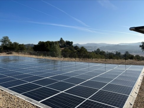

There was another concern Samuelian had to factor into the equation: A private well supplies his home’s potable water and fire protection. To ensure his household would have running water during an outage, he installed a 2 kW solar panel to maintain the well pump and booster pump for the fire protection system. The generator has an auto transfer switch to power both the home and the well simultaneously.
At 30 kW, the solar panel system is larger than your average residential system — it’s as big as you can get before the utility provider would need to do an interconnection study. Samuelian oversized it to account for a guesthouse he’s building on the property.
You won’t find the solar panels on the roof. The system, from Erthos, is mounted flush against the ground. Samuelian, who is an angel investor in the company, says the earth-mount install eliminates the need for costly racking, absorbs heat from the ground to maintain more consistent temperatures, and protects from high winds.
The earth-mount install eliminates the need for costly racking, absorbs heat from the ground to maintain more consistent temperatures, and protects from high winds.
