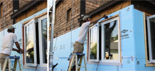

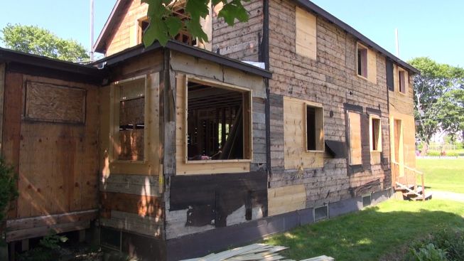

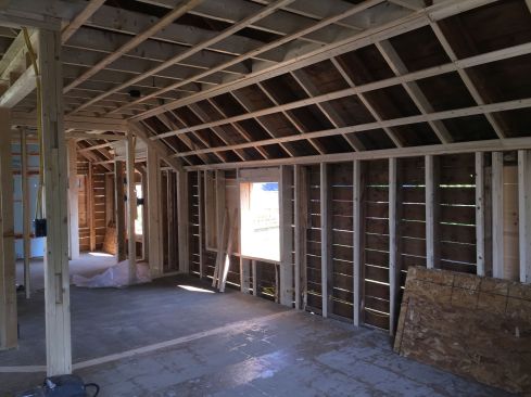

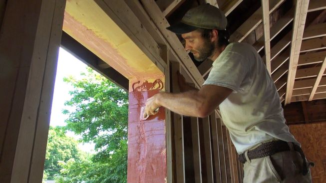

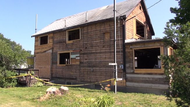

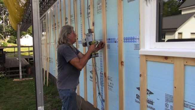

But that situation hasn’t stopped Bangor-based House Revivers from carving out a niche in the energy-upgrade market. The company has a six-home zero-energy development underway on Fern Street in Bangor (one of the city’s so-called “tree streets,” with names like Maple and Birch, where walkability and a neighborhood feel are attractions). And this month, JLC caught up with House Revivers at the job site where David Kelly, son of company founders Bob and Suzanne Kelly, is working with skilled carpenters Jay Kelleher, Sonny Searles, and Rick Martin on a complete gut-rehab of an old Bangor wood-frame house. The goal is to make the house airtight and well-insulated enough to be heated with a pair of mini-split heat pumps (one upstairs and one down), with enough solar photovoltaic panels on the roof to make as much power as the house needs every year.

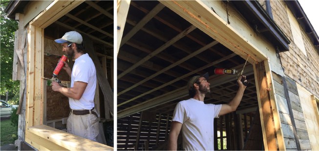

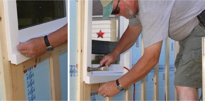

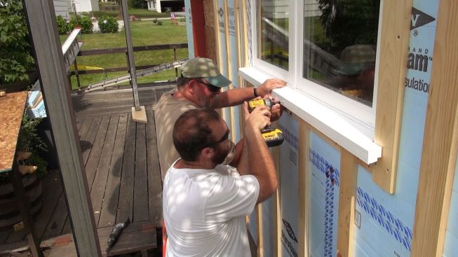

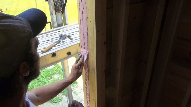

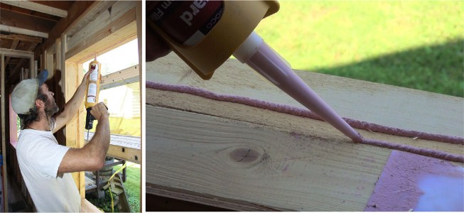

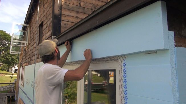

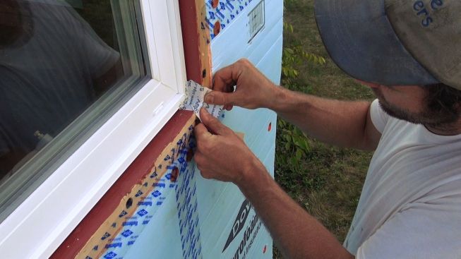

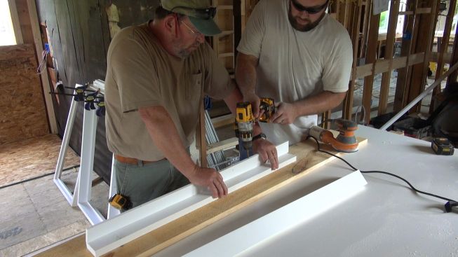

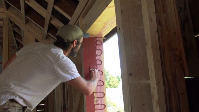

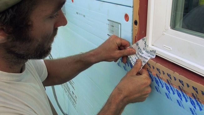

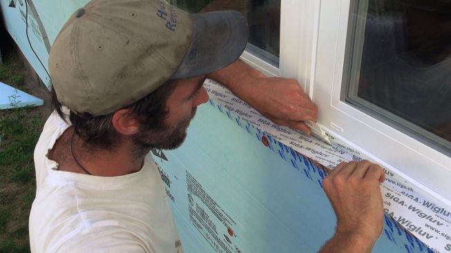

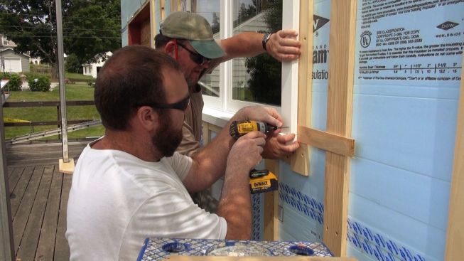

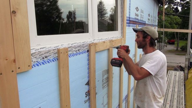

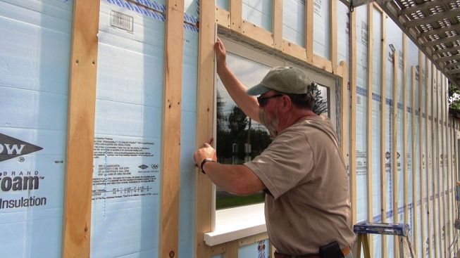

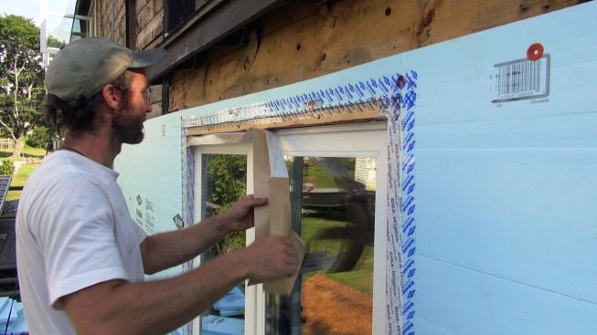

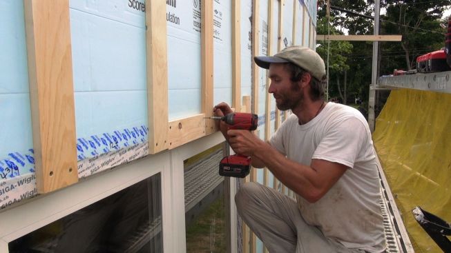

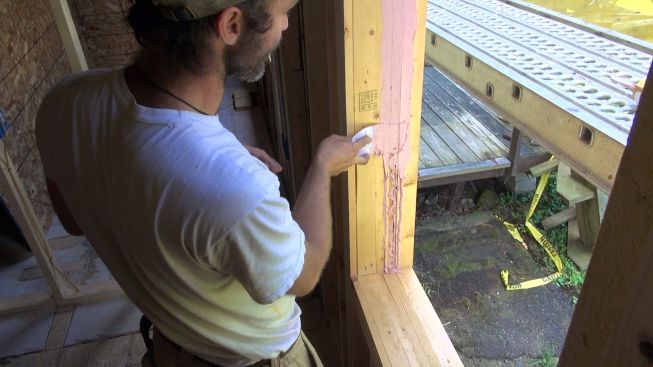

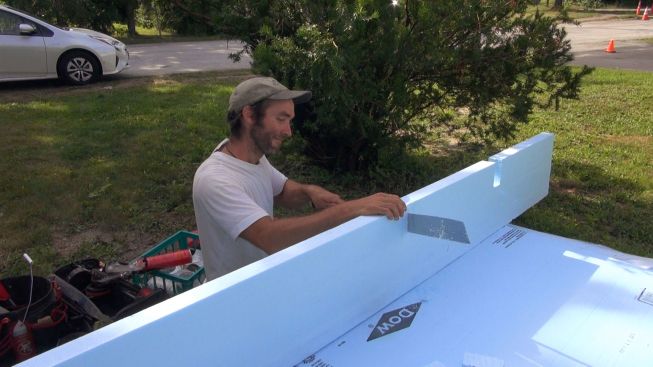

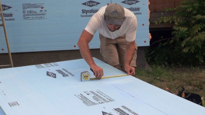

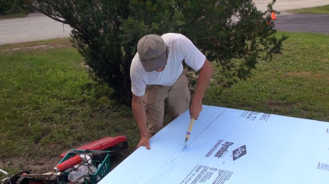

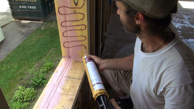

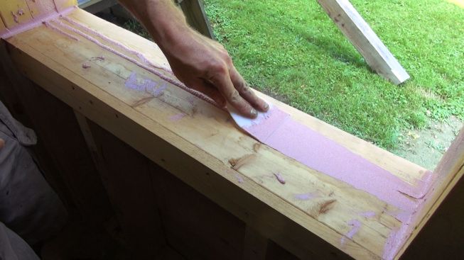

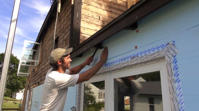

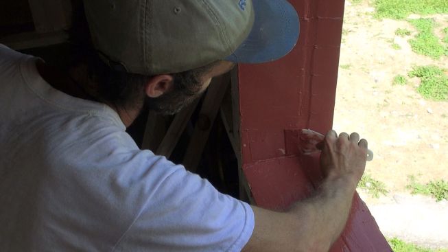

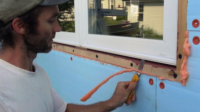

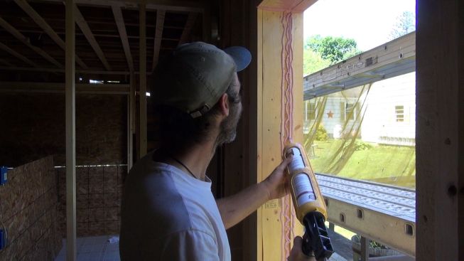

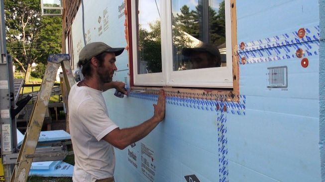

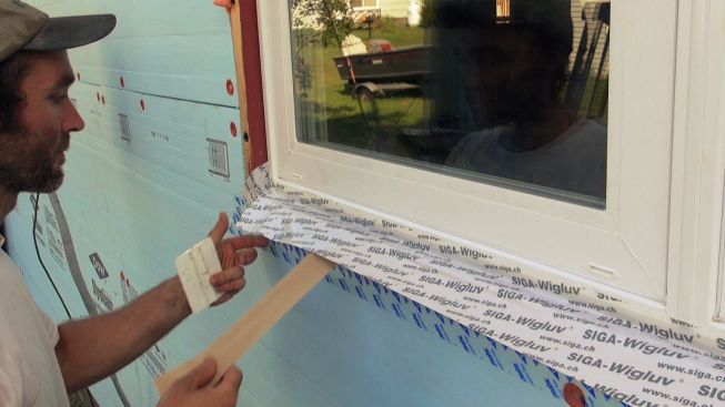

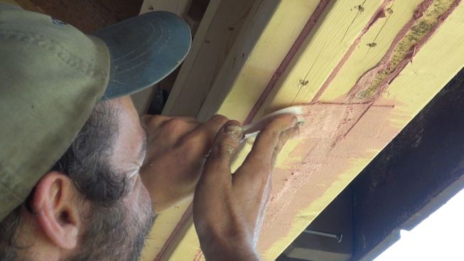

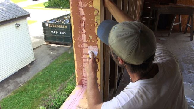

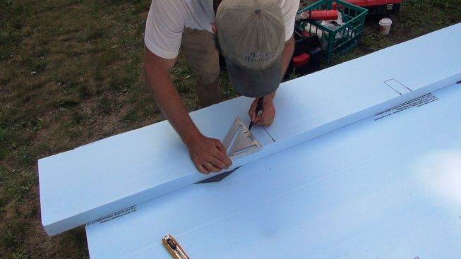

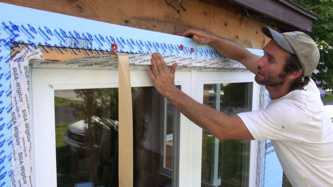

JLC came along in time to see David Kelly applying Prosoco’s wet flashing system to the old home’s new window openings, and then to see Kelly and the crew installing new windows, beefing up the home’s walls with exterior-applied Dow extruded polystyrene (XPS) insulation, and tying the sheathing into the windows with builder’s tape. Take a look.
