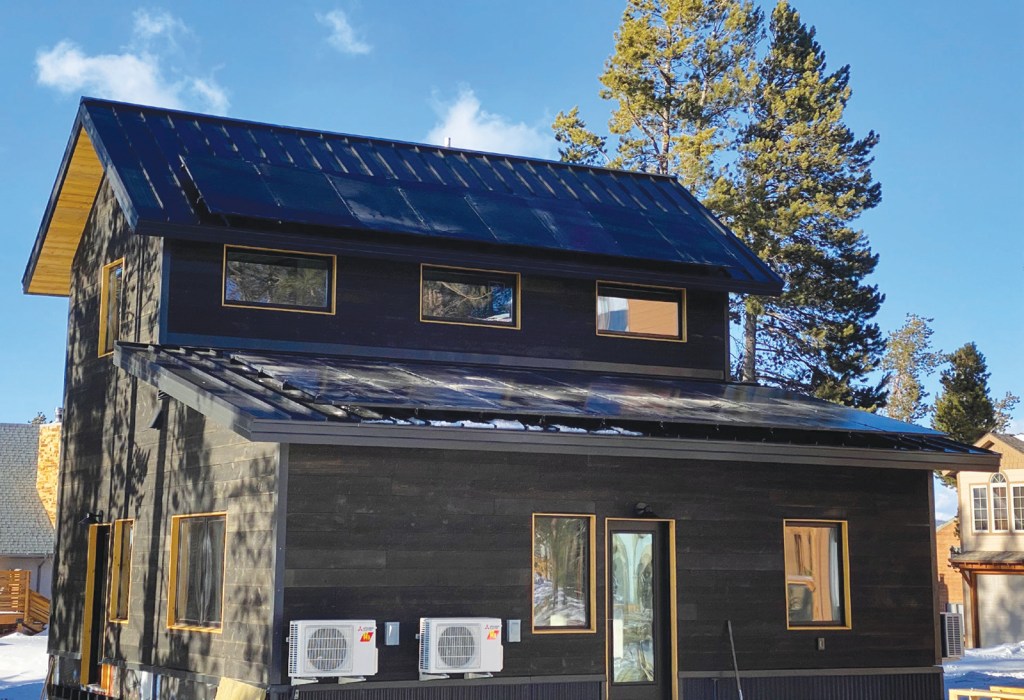

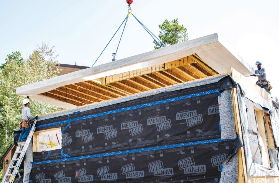

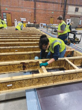

The compact, award-winning design features a 7.6-kilowatt solar array (lead photo). Students prefabricated the wall and roof panels off-site with the assistance of Denver-based Simple Homes, a Swedish-inspired prefabricator of high-performance homes (left). The shell was assembled on-site over the course of a couple of days by the company's set crew (above).
A rotating team of more than 30 students and faculty members worked on the project in the pre-fab facilities of Denver-based Simple Homes where construction began. There, the team learned about the panelization process as they assembled the R-42 wall panels and R-60 roof panels for the 1,176-square-foot, two-story home. After the panels were trucked up to the building site, the setting crew from Simple Homes, the homeowners, and the CU team spent a couple of days assembling the shell. After that, it was a race to complete the project by the competition deadline, with small groups of students commuting up the mountain to Fraser regularly (it’s a two-hour drive) to work on the house alongside the homeowners and local trade partners, all while dealing with COVID-19 restrictions.

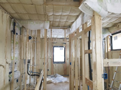

The home's R-42 walls and R-60 roof were insulated with natural wool batts, followed by an Intello Plus combo air barrier/smart vapor control membrane.

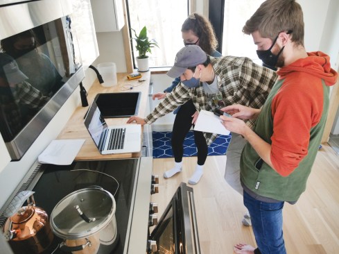

From right, students Ryan Tasto, Jacob Apple and Heather Walker conduct tests in the 2021 Solar Decathlon house entry for the University of Colorado Boulder being built in Fraser, CO. (Photo by Casey A. Cass/University of Colorado)
Shown here are members of the University of Colorado team who are monitoring the completed home’s energy performance.
Housing costs are high in Fraser, so the home was designed with a 300-square-foot rental unit to help provide an affordable option for seasonal workers at the local ski resort. It’s insulated with Havelock natural wool batts, powered by a 7.6-kilowatt grid-tied array, and heated with three cold-climate heat pumps. Along with cold and snow, Fraser also gets a lot of sun—over 300 days per year—so most of the time, the home is selling excess electricity back to the grid. Solar Decathlon judges were so impressed with the results that they awarded the CU team first place in three Build Challenge categories and first overall.
