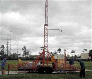

The team planned to make the trips as part of the Florida Coastal Monitoring Program, a nine-year-old UF-led effort to learn more about low-altitude hurricane winds and the forces they impart on homes and businesses.
Heading out from Gainesville in a small fleet of white Ford F250 trucks, researchers tow four trailer-based towers equipped with devices that measure wind speeds, barometric pressure, and rainfall to projected landfall locations. They also keep tabs on 30 homes around coastal Florida modified to include roof-mounted pressure monitors and other devices aimed at monitoring their performance during storms.
The goal: to correlate the low-altitude wind speeds measured by the towers with wind forces on the homes, establishing relationships needed to understand, predict and — with luck — help prevent onshore hurricane damage.

Down-to-earth data. The Florida Coastal Monitoring Program erects towers as close to the path of Hurricane Wilma as possible. Wind-speed data from the towers, along with wind-pressure data from houses wired with instruments, is part of a growing body of real-world data used to establish hurricane-resistant building techniques. Most of the data prior to this has been from buoys that measure hurricane winds over open water or from airplanes gathering it high above the sites where the damage actually takes place.
