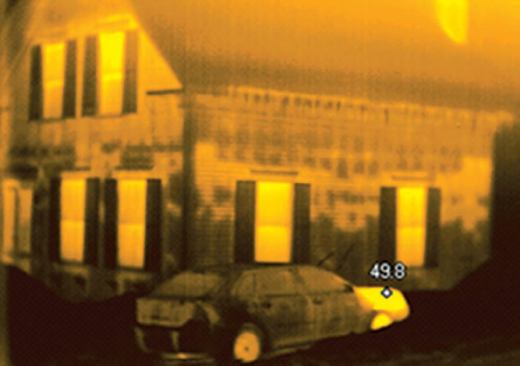

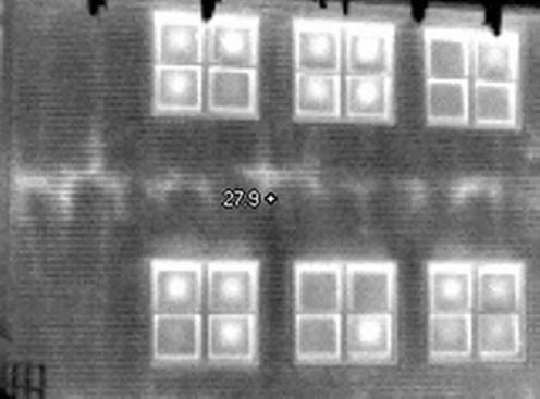

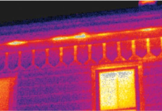

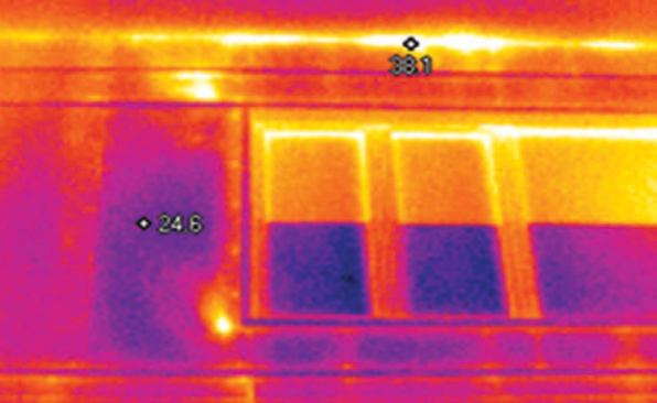

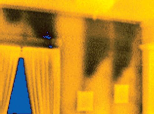

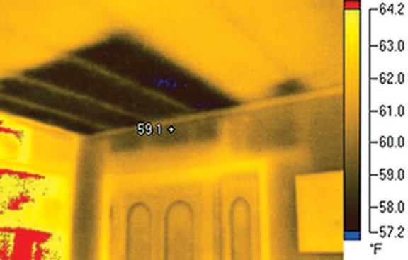

When I arrive at the site of an inspection, I typically start by scanning the structure from the outside, if there’s no sun and enough delta-T for that to work. If I can see the framing, I’ll often be able to see any missing insulation as well. A quick scan from the outside can also reveal problems related to damaged or deteriorating multipane glazing.
If temperature conditions let you work from the exterior, you can usually quickly get an overall sense of the building. In some cases – when conditions are good – it’s possible to conduct an entire inspection from the exterior. But a more detailed assessment will ordinarily require imaging from inside, which is slower because it involves working around furniture, partitions, and other obstructions. I work methodically from room to room and note any problem areas as I encounter them, manipulating the indoor temperature as needed.

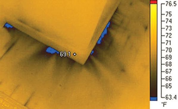

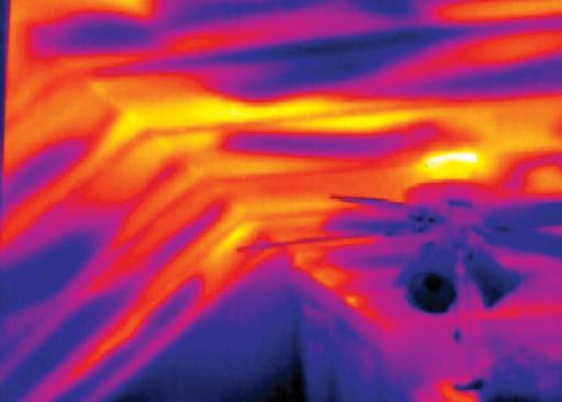

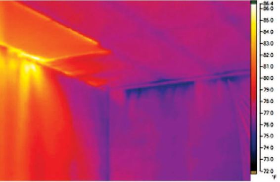

Finding air leaks. Insulation problems can easily be seen at ambient pressure, but air leaks show up much more effectively – and uniformly – if you can depressurize the building. We prefer to use a blower door for this, because we also want to be able to calculate the air infiltration volume; in a pinch, though, any large fan – even a whole-house fan or kitchen exhaust fan – can be used, often with acceptable or even good results.
As soon as the home has been depressurized (before doing so, make sure it won’t cause backdrafting of any combustion appliances), it’s easy to see air leaks from inside. Most leaks will show up quickly, but in areas where air is being tempered by a “plenum” (such as a knee-wall cavity) they may not become evident for up to 20 or 30 minutes.
