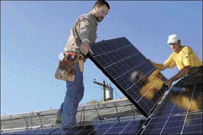

Production manager Charlie Morgan (left) and Ben Philbrick of Rhode Island-based SolarWrights maneuvers a photovoltaic panel into position on the roof of a Connecticut home. Then State of Connecticut puts up a per-kilowatt subsidy that makes the upfront cost of PVs easier to swallow — a trend that may catch on in other states as green building incentives become an increasingly important issue for policy makers.
