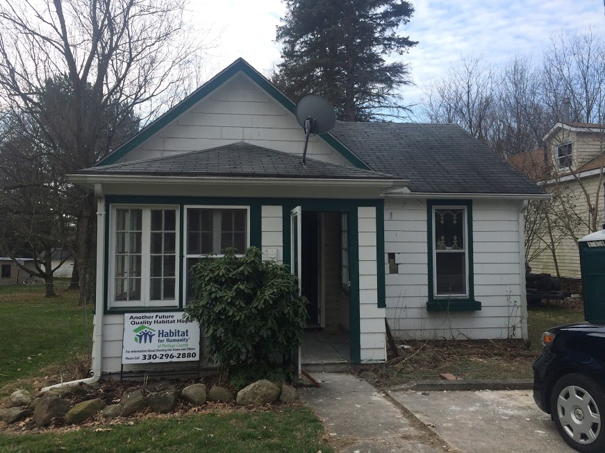

This Habitat affiliate, Habitat of Portage County, does about 50/50 new builds/rehabs. This is a rehab project.

  • The clients – Provide a comfortable, healthy home that’s inexpensive to operate for the clients, a single mom and her 17-year-old son.
  • Bleeding edge – Push the boundaries for retrofits on airtightness and HVAC design. Remove the gas meter and go all electric (saving $300/year in meter fees).
  • PR – Hopefully, use the story of the project to attract more funding for more projects.
  • Leadership – Perhaps influence how Habitat views home performance and efficiency nationally.
