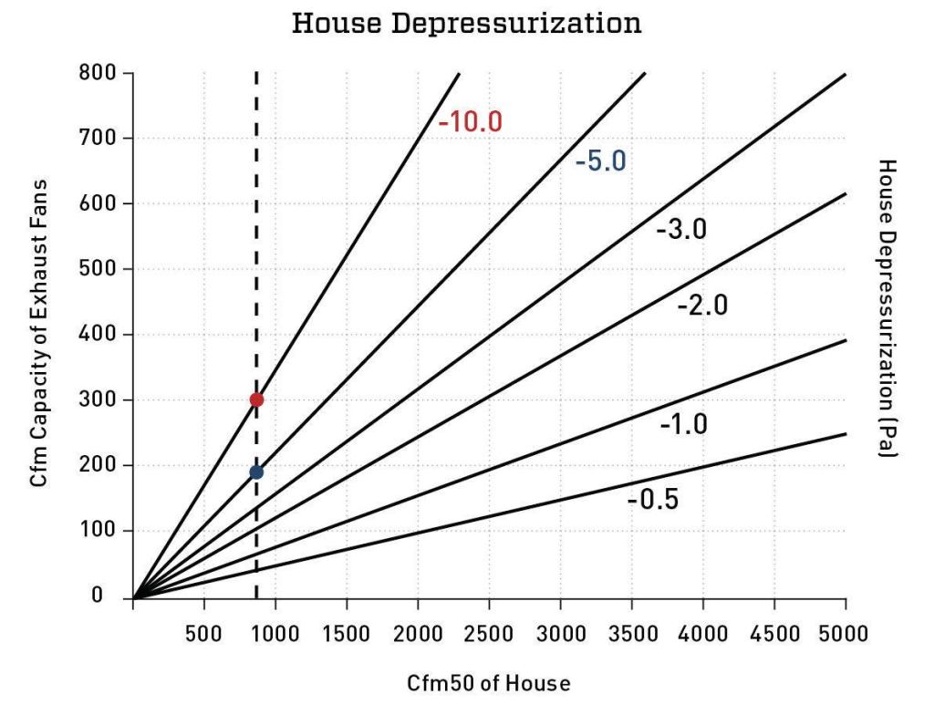

A 300 cfm exhaust fan can depressurize the leakiest 2,000-square-foot home allowed by code (blower door at 900 cfm50, as indicated by dotted line) to -10 Pa (red dot). No natural-draft gas appliance in the home could safely draft under these conditions.

CAZ safety limits established by the Building Performance Institute show that natural-draft gas appliances can suffer backdrafting when placed under a pressure of as little as -2 to -5 Pascals (Pa). When a home is very tight, even very small exhaust fan flows will exceed these safety limits. Take a 2,000-square-foot home with an average ceiling height of 9 feet (volume = 18,000 cubic feet). To meet the 2012 code, this house would have to test-out at 900 cfm50. This is the leakiest a home this size can be built under the 2012 code. What happens when you turn on an exhaust fan in this home?
The chart shown here depicts the relationship between tightness, airflow, and depressurization. The vertical dotted line represents 900 cfm50. The red dot represents what happens when you turn on a 300-cfm kitchen exhaust fan. A natural-draft gas water heater depressurizes the house to -2 Pascals, which is the BPI CAZ safety limit. But the 300 cfm fan will depressurize the home to -10 Pa. This is twice the safe maximum depressurization allowed for a gas furnace and two to three times what a natural-draft gas water heater can safely operate against. Turning on a clothes dryer or two bathroom exhaust fans to generate an exhaust flow of 200 cfm (blue dot) will result in a depressurization of -5 Pa. This says nothing about any “worst-case depressurization” scenarios when all exhaust appliances may be operating and bedroom doors are closed. Homes built tighter than this will experience even greater depressurization as the dotted line shifts to the left.
What’s the solution? It’s easy: If you seal to the 2012 IECC requirements, install only draft-induced or sealed combustion appliances. Any natural-draft combustion appliance is a disaster waiting to happen.
