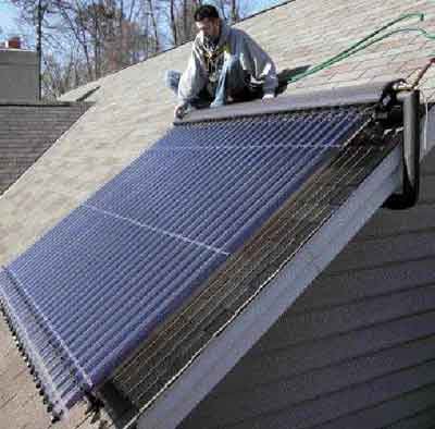

Now the tax incentives are back (see sidebar, “Tax Incentives for Solar”), the solar industry is thriving, and I’m determined to pick up where I left off nearly 30 years ago. To educate myself — so that I can offer my clients good systems suitable for our cold northeastern climate — I recently installed a Viessmann Vitosol 300 vacuum tube array (www.viessmann-us.com) on my own house in Pennsylvania. Vacuum tubes are more expensive than other types of solar collectors, but they can generate a considerable amount of hot water even in overcast conditions (see sidebar, “Does Solar Make Sense?”).

My system consists of a 30-vacuum-tube array with about 33 square feet of collector area. When sunlight shines on the system’s solar collectors, heat absorbed by copper-plate and tube assemblies within each evacuated glass tube turns the fluid sealed inside to steam vapor. This vapor rises into a condenser contained within the system’s double-pipe heat exchanger. Here, energy is transferred to a glycol-water medium, while the vapor condenses back into a fluid and flows (via gravity) back down into the vacuum tube to repeat the process.
When fluid temperatures in the collector’s heat exchanger exceed the water temperature in the storage tank, my system’s circulation pump is activated by a Vitosolic 200 differential temperature controller, which circulates the heat-transfer medium through a second heat-exchanger coil in the system’s storage tank.

Because a vacuum-tube array can be disassembled, it is light and can be installed fairly easily by one person. And since the tubes aren’t filled with water, the unit isn’t heavy even when fully assembled and installed; most roofs can easily accommodate the load without any additional structural reinforcement.
One of the biggest challenges when installing one of these systems — particularly when retrofitting a new unit onto existing housing — is finding an inconspicuous route for the piping between the basement storage tank and the solar array on the roof. The easiest path often isn’t acceptable because it exposes the pipes to view. In our case, the only aesthetically acceptable route was through a series of floor joists that extended out over a concrete garage floor. This turned out to be the toughest portion of the entire installation.
