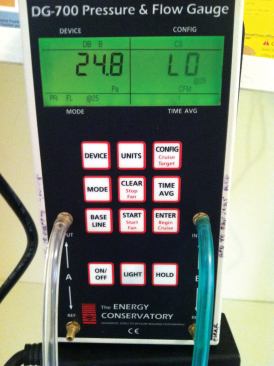

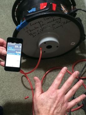

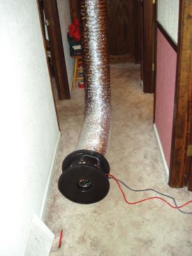

The exclusive membership sought by these companies is called the Ring 4 Club; its only members are those who have supplied proof of installing ducted systems that don't leak. The origin of the name is from the use of the Energy Conservatory's Duct Blaster to measure duct leaks. The Duct Blaster system consists of a calibrated "fan" that connects to the HVAC duct system, and a digital manometer that converts pressure readings into volumetric airflow in cubic feet per minute (cfm).
The fan device has a wide operating envelope for measuring very leaky duct systems. When measuring tighter duct systems, you use one of three numbered adapter rings, whose successively smaller holes increase the fan pressure, which provides greater accuracy when measuring smaller leak rates.
When measuring the tightest duct systems, the user installs "ring 3," the one with the smallest hole. This enables the manometer to record leaks as small as 10 cfm, equivalent to about 1% air leakage for a 2 1/2-ton central air conditioning system. When meticulous installers put together ducted systems that leak less than this, the display flashes the word "LO," which is a signal to install the next higher numbered ring.
We now have "ring 4" (photo 1) for the Duct Blaster and have recently instituted the Ring 5 Club as well, for those who can reach "LO" with ring 4 in place.

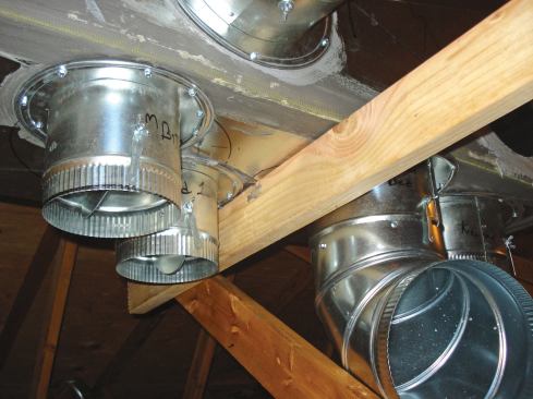

I'm often asked how difficult it is or how much more time it takes us to assemble ultra-tight, Ring 4- or Ring 5 Club–eligible distribution systems. The answer is that it is no more difficult and takes no more time, and the reason may surprise you. It's because, from the start, our company decided that any leak was too much. We developed standard procedures that make zero leaks an automatic occurrence on every project.

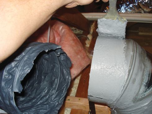

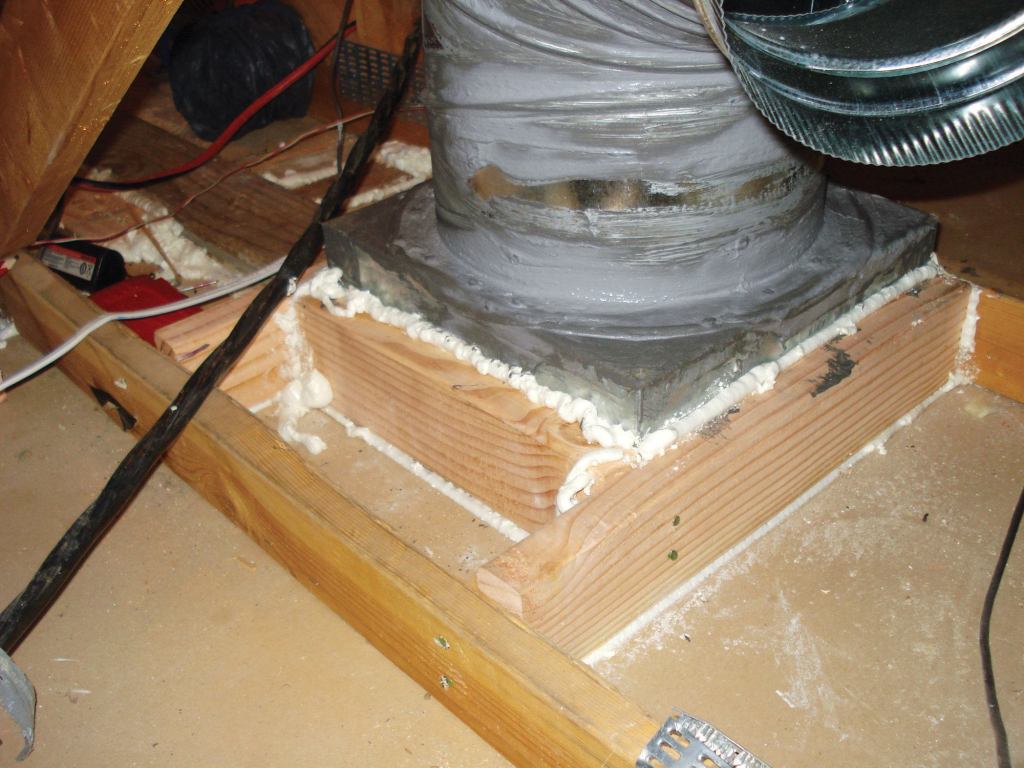

Our crew knows that when metal parts show up on the jobsite, for example, they are wiped down with denatured alcohol in preparation for receiving future sealant. And when supply boots are cut in, they're caulk-sealed and foamed in place before the crew moves on to the next one. All adjustable elbows that are installed anywhere there is a planned deviation from a straight run of flexible ductwork are taped, secured, and coated "nickel-thick" with mastic and left ready for flexible duct installation after curing. And all plenum attachments and joints are made with lots of screws and collared takeoffs, using jugs of mastic and reinforcing mesh as needed.
Because the parts are methodically installed using appropriate materials, the system simply ends up being airtight. In fact, we would have to think about how to make a system leak, which would take us more time than our standard practices do now. So don't you think it's time for you to adopt a higher standard and reward yourself, your tradespeople, and your customers with excellence?
