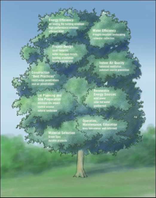

To conceptualize the big picture of what green building entails, think of a tree with nine main branches. All are important and interrelated, but some — namely energy and water efficiency — should be considered higher priorities and take a more prominent position in the overall green plan for a project.
Energy first. Energy improvements sit at the top of all green building priority lists for good reason: Energy consumption represents an ongoing expenditure of resources. In all coastal climates, focus attention on air sealing measures at critical framing connections. One example is the band-joist area on this Florida home (left), which has been sealed with spray foam to stop air and provide optimal insulation. Attic bypasses, such as the holes created by routing wiring through an attic (right), are critical but often overlooked energy drains.
The important thing is to understand green building on two levels: the big picture and the more fine-grained details of implementation. You’ll communicate with clients wearing your “big picture” hat. To provide a better understanding of this big picture, I break down green building into nine different branches of a tree (previous page). Not every branch is weighted the same, but none can be ignored. A perusal of the outline provided here will provide a quick check on how close you’re already coming to building green and detail what practices you might need to reach the goal.
