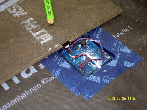

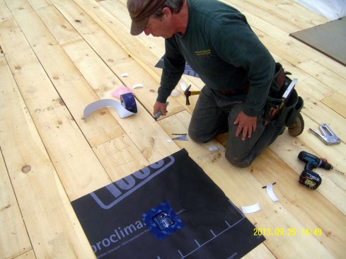

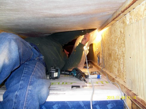

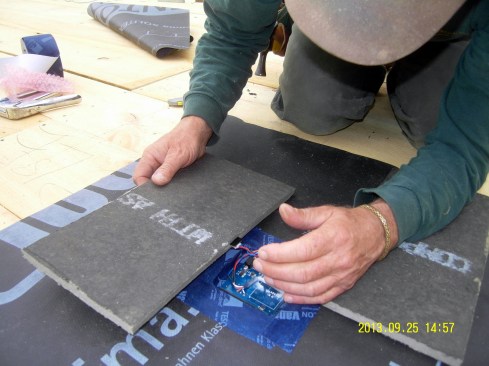

Root, and PHIUS, also took into account the measures Miksic and Whitchurch took to verify the theory: They installed three different kinds of moisture and temperature sensors at key locations in the building assembly, and they’ve been monitoring the building to observe whether its performance met their expectations.

And builder Miksic said this roof has a number of specific details that, if changed, could alter the assembly’s performance. For one thing, the small, 24-foot-square roof is vapor-open at the edges, with a permeable membrane on all four sides allowing vapor to escape into soffit vents. Second, during the summer, the dark EPDM roofing heats up in the sun, which helps to drive moisture through the smart membrane underside into the indoors. A white roof, a vegetated roof, or even shading from solar panels would change the roof’s performance. A third factor is lumber choice: The roof is sheathed with solid-sawn pine, not with OSB or plywood, which are less vapor-permeable and more moisture-sensitive. “And there’s a fourth, very important factor,” said Miksic: “Quality of construction and airtightness. The vapor control layer, the Intello, is also the airtightness layer in this roof, and has to be meticulously air-sealed. You need a continuous vapor control layer and air barrier.”
