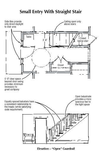

Straight Stair
Consider the moderately scaled traditional entryway, which includes vertical circulation space to the second floor as well as horizontal circulation in three directions. The single-run stair is set off to one side of the hall to save space in this relatively tight passage. To avoid feeling cramped, an entry benefits from a 5-foot clear space beyond the swing of the front door for greeting guests, which this plan just achieves.
Had an L-shaped stair been used instead, it would have closed off the straight-ahead path to the rear of the house and forced all circulation through the more formal front rooms to either side. At 3 feet 6 inches wide, the stair shown here is more comfortable than the general building code minimum width of 3 feet, but it’s not overly grand and doesn’t draw too much attention to itself.
The no-nonsense mood of this entry extends to the opening in the floor above, which is no larger than the stair itself. While it might seem appealing to give the entry a more open feel by enlarging the opening above, that could be a mistake, limiting upstairs floor space and privacy without improving the downstairs.
