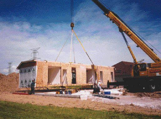

Each module arrives on the building site on a steel carrier towed by a tractor-trailer rig. Pitched roof sections are folded down for shipment. Windows, doors, and most exterior trim are already installed, and the front and back walls are covered with vinyl siding enclosed in a protective wrap. The gable ends will be sided after the installation is complete. After the modules are delivered, two or more carriers can be stacked for the return trip to the factory. The rear module is craned onto the foundation first, with its roof still in the folded position. The set crew powder-fastens support posts to the basement slab and bolts them to the central LVL girder.
