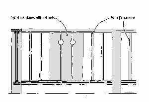

Eclectic Carved Plank Rail
While still informal, this is a more sophisticated pairing of cut-out planking and linear balusters. Here, the pattern alternates between opacity and transparency. A continuous top rail helps keep the arrangement simple and more contemporary.
Unlike the previous example, this railing looks the same from both sides. It suits a variety of home designs, from older cottages to new custom homes that highlight wood craftsmanship.
