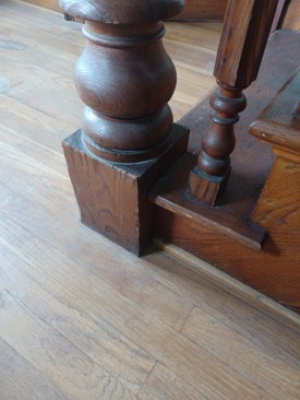

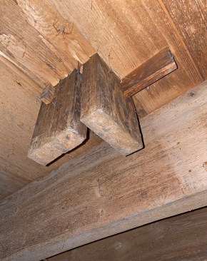

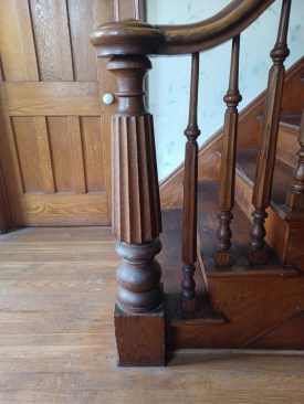

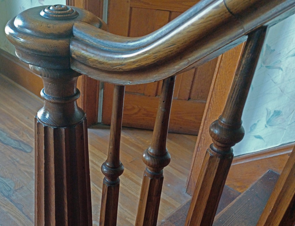

Arguably the most charming woodwork in the home is the stair to the second floor, and never have I walked on a set of wood stairs as old that didn’t creak and have a wobbly handrail. This stair is silent and immovable, and the newel, a single piece of turned oak with carved flutes and an integral pedestal set into the first step, feels as rigid as a tree trunk. When I looked to find out how it was secured, I found something I’d never seen: The bottom end (below the pedestal block) is cut into two opposing tenons that are mortised through the subfloor (see photo 3 in slideshow, above). Each tenon has a slot cut into it at subfloor level, and an oak wedge was driven into each of these slots to draw the post straight down, snug to the floor. To complete the connection, the pedestal is braced by the stringer and the first riser and tread and locked in by finish flooring.

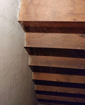

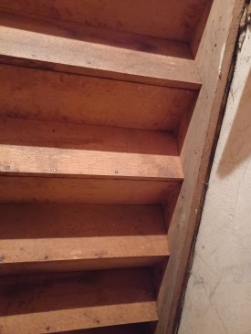

As for squeaks, there is no substructure, no glue and screws, just good wood and not as much of it as I’d expect—one set of 1-by oak treads and risers supported by 1-by oak stringers. (Granted, all these pieces are a full inch thick and cut from tight-grained, rift and quarter-sawn oak, which probably best accounts for their resilience.) On the closed side of the stairs, the stringer is nailed to a 1-by oak apron nailed to the wall. On the open side, the finish stringer, which is also the carriage, is supported by a flat-framed wall tied together with oak laths and plastered on both sides.
