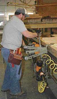

Semiautomated Panelizing
If a builder is producing 30 or more homes a year, it might be worthwhile for him or her to consider a semiautomated manufacturing facility — the kind of operation we use. While a plant like ours can be profitable building around 30 units per year, it’s capable of doing as many as several hundred units.
For our company, we found this type of manufacturing operation ideal not only because of our size but because the approach requires actual carpenters, not factory workers. We need experienced carpenters to produce our sophisticated trim details, and we find their experience and problem-solving skills invaluable on our assembly line.
A significant jump in efficiency inevitably accompanies a move — such as ours — from a manual operation to a semiautomatic plant, mainly because panels start moving down an assembly line. When we made the switch, we began turning out wall panels about five times faster than previously; quality was as good as or better than it had been with manual methods.
The cost to fit up a semiautomatic operation, however, is significant. For one thing, the facility needs to be big enough to house the equipment. Eight thousand square feet is probably minimal. And for another, the equipment itself is not cheap. Most semiautomatic plants include the following components, which constitute “the line.”
Plate marker. The first machine is the all-important plate marker. This computer-driven cutoff saw with an automatic stop is programmed to recognize and keep track of every piece of cut framing lumber in the house. It also lays out the top and bottom plates, so one man can do the complete layout in a matter of hours. It’s our most essential tool; the speed of the entire assembly line depends on not getting bottlenecked at layout — just as with framing on the job site.
