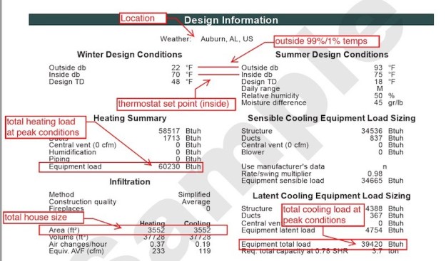

Furthermore, the industry is currently lacking a robust workforce of HVAC professionals with the level of expertise, specificity, and accuracy needed to address the complexities of high-performance mechanical design. Take, for example, the ACCA Manual J tool which estimates the heating and cooling loads based on building size, glazing, orientation, climate zone, air tightness, R-values, occupant preferences, and other factors. Municipal permitting offices are increasingly requiring Manual J calculations to determine mechanical equipment sizing, but unfortunately many reports are fudged.
Energy Vanguard Heating and cooling load calculations based on ACCA Manual J are an important first step in any hvac design, and many municipalities are increasingly requiring these calcs at permitting. Done well (and not fudged by the mechanical contractor) it's only a starting point for selecting equipment.
Building science expert, author and mechanical designer Allison Bailes explains, “A lot of HVAC contractors aren't used to doing real design. They work by rules of thumb, and if a building department says we need the Manual J, then they'll crank one out. But if they don't do this regularly and know what they're doing, a lot of times they’ll manipulate the numbers until they come up with their desired load for the system.”

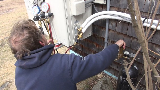

Proper system design is critical, but don't forget that every system should also be commissioned through a process of tests that ensure the installed system performs as designed. Pressure-testing and vacuum-flushing the lines is an important step in commissioning a new heat pump.
