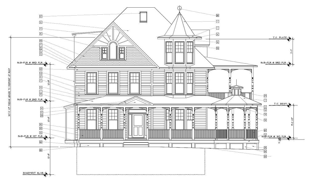

Proposed Front (East) Elevation

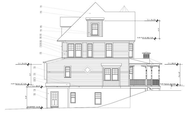

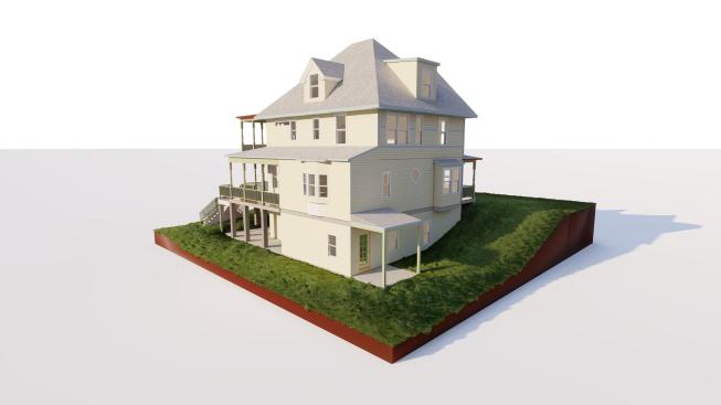

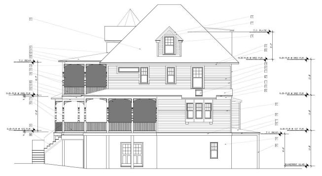

How far would you go to rebuild a cherished 1901 Queen Anne Victorian-style home that succumbed to a tragic fire? Would you jump at the chance to revive this classic turn-of-the-century aesthetic marked by intricate, hand-crafted carpentry work, a panoply of audacious roof pitches, and resplendently ornate interior finishes? Presented with the opportunity to build from the ground-up a near-exact replica of an original Victorian, would you consider merging this historic architecture with a net-zero standard of high performance?

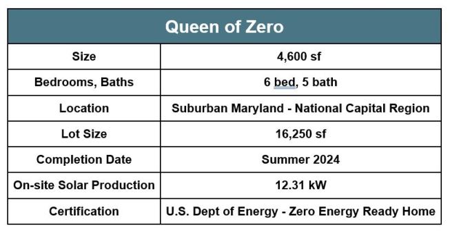

Welcome to JLC‘s Queen of Zero case study 2024. Over the next year (or so), I will be sharing this story of rebirth – a phoenix of a house rising from the ashes to become the first newly built Queen Anne Victorian to meet the U.S. Department of Energy’s Zero Energy Ready Home (ZERH) standard.
Aligning Net-Zero Performance With Victorian Design

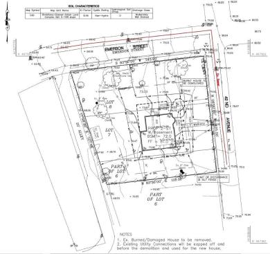

The property is located in a historical district of suburban Maryland just outside Washington, D.C. Though the area was once full of stately Victorians, the stock of these centenarian balloon-framed antiques has dwindled significantly. The neighborhood is now predominantly a mix of mid-century bungalows and newer, production-built Craftsman-style homes.
Queen of Zero’s homeowner, a longtime Maryland resident with a deep appreciation for historic preservation, explained that after the fire, “it was never a question of whether we would rebuild” the original home. Yet, recognizing the demands of a changing climate and rising utility costs, the owner is also seeking to modernize the functional aspects of his new home with advancements in energy efficiency, resiliency, and comfort. To achieve net-zero performance, Queen of Zero will incorporate a host of innovative products and materials, such as a Tesla solar shingle roof and an exterior shell made of structural insulated panels (SIPs).
