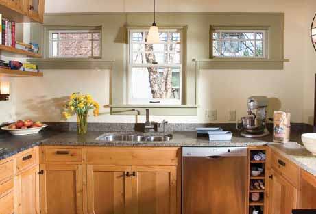

To bring in more natural light, we added a pair of windows to the kitchen’s north wall. We also replaced the existing double window overlooking the backyard with a slightly shorter insert that accommodated the flex space’s full-height countertop. As a rule we avoid any kind of vinyl product; here we chose Pella Architect Series metal-clad wood windows, which offer a good combination of looks, durability, and thermal performance. Though not triple-glazed (our preference), the double-glazed units were a significant upgrade over the home’s single-glazed originals.
Instead of tossing demolition waste in a dumpster, we reuse as much building material as we can and recycle the rest. On this project, we trimmed the new windows with material salvaged from the existing kitchen and sent the old cabinets to a local re-use center.

Whenever possible, we source materials locally and avoid excessive packaging. We had this kitchen’s cabinets built at a cabinet shop located less than 15 miles from our office. The cabinet boxes were made from a prefinished maple plywood with no added formaldehyde, while the frames, doors, and drawers were built with alder, a fast-growing wood that looks like cherry.
We used low-VOC stains and finishes from Sherwin-Williams on the cabinetry, and Benjamin Moore’s Aura (a low-VOC paint) on the walls, ceiling, and trim. Exposure to VOCs — which are found in most sealers and paints, as well as in adhesives and caulks — can lead to health problems like asthma and cancer. The long-term impact of these compounds on the environment is a big concern, too — VOCs are essentially smog. Low-VOC finishes usually cost the same as traditional materials; using them is an easy way to remodel green.
We like to work with prefinished flooring because the coating process takes place in a controlled environment with appropriate measures in place for pollution control; no VOCs are added to the home. Moreover, a factory-applied finish is much more durable than a site-applied water- or oil-based polyurethane.
For this floor we used a hybrid wood called Lyptus. A rapidly renewable resource (it grows to maturity in around 12 years), Lyptus is straight, dense, and easy to work with. At the time of installation, we liked it a lot and were using it on several projects. Recently, though, we decided to install only imported woods with a full FSC (Forest Stewardship Council) chain of custody certification (www.fsc.org). Unfortunately, Weyerhaeuser — the company that co-produces Lyptus — has tried and failed to certify it, prompting us to discontinue our use of it. Sorting through the hype to find materials or systems that are indeed what they claim to be is one of the most challenging parts of the green building process.
All of the kitchen’s countertops are made from honed remnant granite — partial slabs or drops left over after the fabrication of larger projects. We work with local fabricators to keep these pieces out of their dumpsters and incorporate them into our projects.
