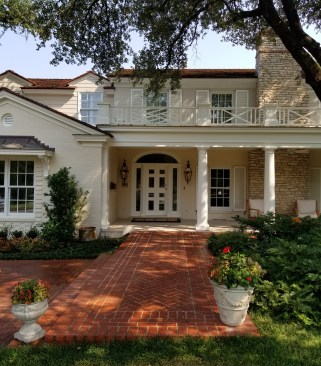

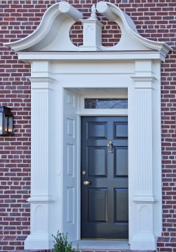

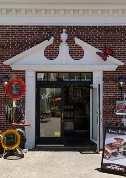

Scale has to do with size. For instance, when a pediment is too large for its door (see photo, below left), it dwarfs the columns and throws off the proportions (the relationship between parts). In the correct way to execute a Georgian-style doorway, the elements are balanced, with columns sized to visually support the elaborate pediment (see photo, below right).
A poor attempt at a Georgian Colonial entry: Notice how the pediment is too wide, and how the oversized pediment dwarfs the columns, which look spindly by comparison.
Without question, the Georgian style is elaborate. This doorway shows  a proportionally correct interpretation of a Georgian entry.

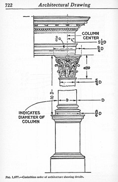

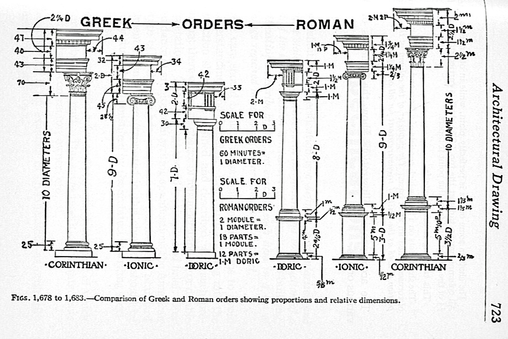

Often, historic design, like the well-proportioned door example, was based on well-defined rules for building—guidelines grounded in the Classical orders of architecture. The 1926 edition of the four-volume Audels Carpenters and Builders Guide by Frank D. Graham and Thomas Emery included examples of good design and taught carpenters scale and proportion by introducing the Classical orders (see excerpts, below).
The 1926 edition of Audels Carpenters and Builders Guide included instruction on the Classical order of architecture. Shown above is a comparison of the Greek and Roman orders showing proportions and relative diameters.
Another example of Audels instruction on the Classical orders: Here is  an explanation of the proportion of the elements for a Corinthian column and pediment (each part sized as a multiple of the column diameter).

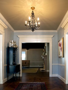

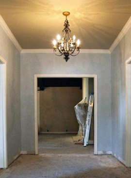

The same lessons can be found in woodwork and trim. Moldings and trim on fine homes built from the Georgian period up through the 1940s are typically much more complicated and more intricate than those on houses today. Historically, an entry pediment was built by hand on site by a master builder, whereas today, pediments can be bought online and delivered ready to install. All millwork, in fact, before the industrial revolution of the 1850s was handmade. Thus, the skills of the craftsmen tended to be higher because they were required to build all windows, doors, mantels, and the like on site, and there was generally more woodwork in homes, including wainscot, window panels, crown molding, and interior pediments. Nothing could be ordered online. To raise your game and improve your skill as a craftsperson, practicing and copying details from the past is the path to finer skills.
Before. The author's company set out to replace the trim on this house restoration.
After. The completed interior by Hull Works with all woodwork restored.

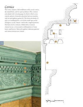

A sample page from the author's book - Traditional American Rooms - offers examples from past architectural treasures, including these examples in England: the Chiswick House in West London (upper right and lower right ), and the Queen's House in Greenwich (lower left). It's work like this that inspires the author to travel and learn from the work of past carpenters.
A sample page from the author's book – "Traditional American Rooms" – offers examples from past architectural treasures, including these examples in England: the Chiswick House in West London (upper right and lower right ), and the Queen's House in Greenwich (lower left). It's work like this that inspires the author to travel and learn from the work of past carpenters.
