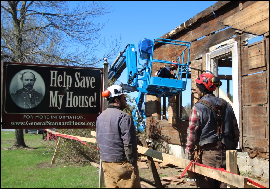

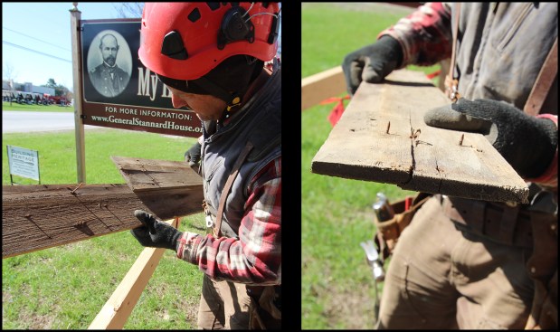

The author’s company, Building Heritage, was tasked with documenting, carefully dismantling, and storing the historic farmhouse for a later restoration on a new site. The restored General Stannard House is to serve as a key location on the newly-formed “Vermont in the Civil War Heritage Trail”. Here, author Eliot Lothrop (right) talks with project volunteer, Alex Fenton, (left) on site. Dan Lee of Building Heritage begins removing the home’s wide board sheathing from a personnel lift.

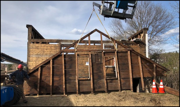

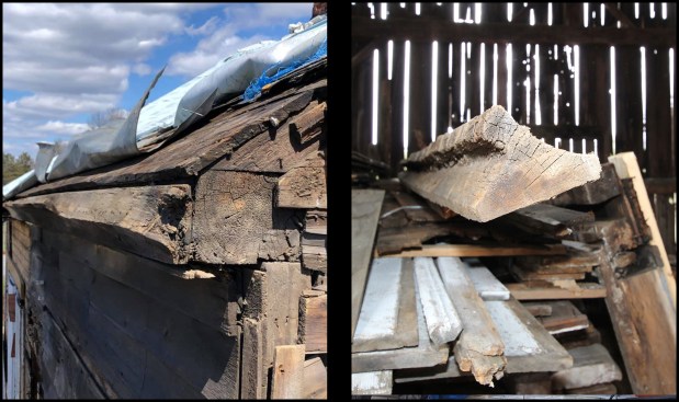

Although the roof was covered by four layers of asphalt shingles, two tarps and two layers of underlayment paper, it still leaked, causing the bulk of the damage to the home’s structure. Here, the roof sheathing and shingles are removed in small sections from the lift.

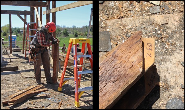

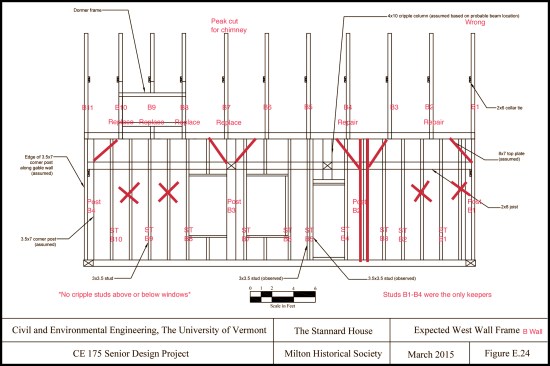

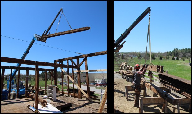

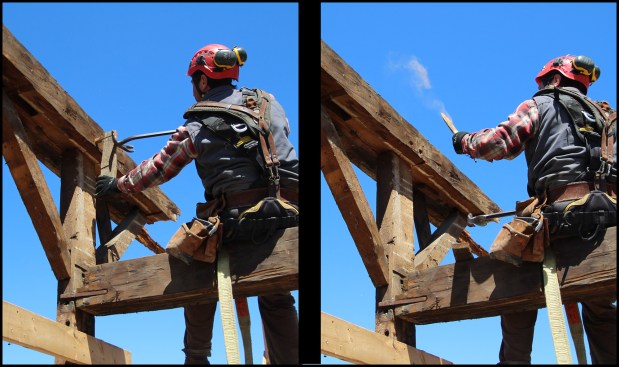

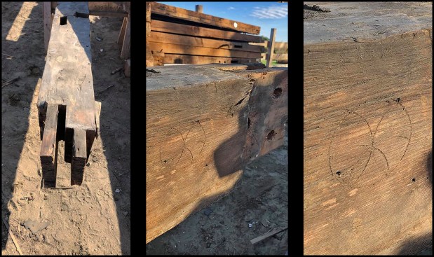

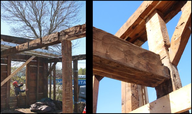

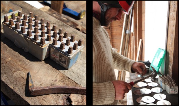

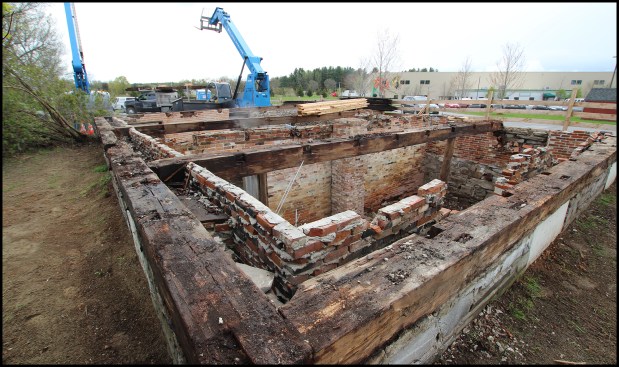

We tagged all the timber framing with coded hand-stamped tin discs, nailing them to beams, posts, studs, and rafters (we later documented their locations on a set of drawings). Then, with the help of a telehandler and personnel lift, we started dismantling the building.

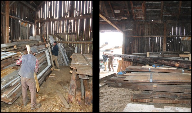

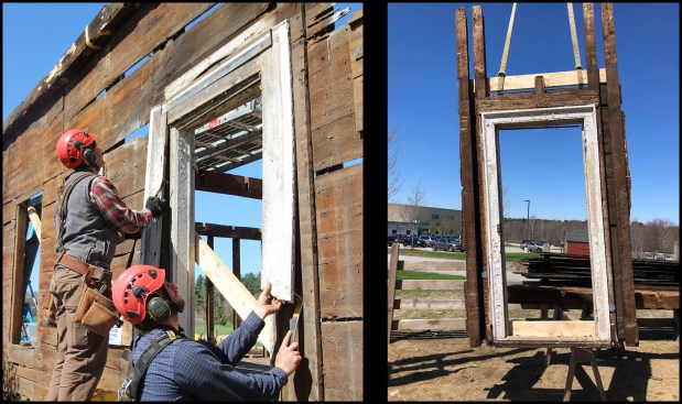

The home’s wide board sheathing was salvageable. The doors and windows, though not all original, were also saved (in general, we could tell what was circa 1900 and newer, but it was difficult to tell what items, such as interior moldings, etc., dated to Stannard’s time). In the end, we salvaged about half of the home’s original structural frame.
The salvaged pieces have been stored and are waiting to be incorporated into the home’s restoration on a new site. The ultimate project goal is to have the house reconstructed by October 20, 2020, which will be General Stannard’s 200th birthday. Visit generalstannardhouse.org for more information about the project.
