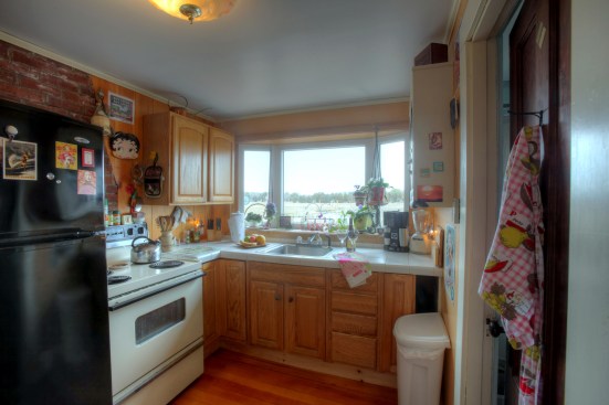

The original kitchen was outdated with full-size appliances and no dishwasher. Smaller appliances and an altered cabinet layout would allow for additional counter space and the inclusion of an 18-inch-wide dishwasher.
At the top of the list was replacing the cottage kitchen. We began by purchasing a new, highly efficient—but smaller—refrigerator. We also bought a new, smaller gas (propane) range to replace the old electric stove. When we looked into getting the range hooked up, we were told that adding a gas appliance meant running a new line, which meant pulling a permit, which meant bringing that entire system—in place since the 1940s—up to 2018 code.

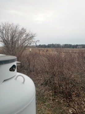

Heat and hot water in the cottage used propane as the fuel. Adding the gas stove would mean moving the tank away from the marsh side of the cottage.
A quick check by the plumber revealed that the gas lines were woefully undersized. Plus the propane tank was currently located about 6 inches from the north (marsh side) of the cottage. Current code puts the minimum safe distance for the tank at 3 feet from the building. But because the back of the cottage abuts the marsh, moving the tank 3 feet from the house would require special dispensation from the conservation folks, which can be frustrating and time-consuming at best, to say nothing of messing up the views from that side. So our solution would be moving the tank to the opposite side of the cottage and reinstalling it just beyond the outdoor shower, where it would have better access for filling as an added benefit.

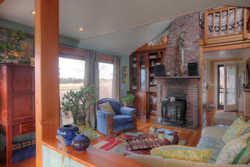

A gas-fired fireplace insert provided the principle source of heat for the west portion of the cottage.
The tank had been supplying propane for hot water as well as for two indoor space heaters. One of the heaters, a wood-stove look-alike mounted in the brick fireplace, heats the west end of the cottage.

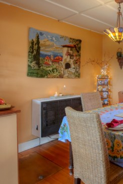

A gas space heater dating back almost a half century was the other heat source for the cottage. It was grossly inefficient and the pilot light frequently blew out in storms.
The other heater, in the dining room at the east end of the cottage, always reminded me of something that belonged in the Smithsonian. Aside from being woefully inefficient, its pilot light seemed to blow out at the most inopportune times, and relighting it amounted to a game of roulette with matches and highly explosive gas. Having tired of that adventure, we decided that part of the cottage upgrade would be a new heating system. From my experience working at JLC, we figured that the simplest and best upgrade would be installing mini-splits.

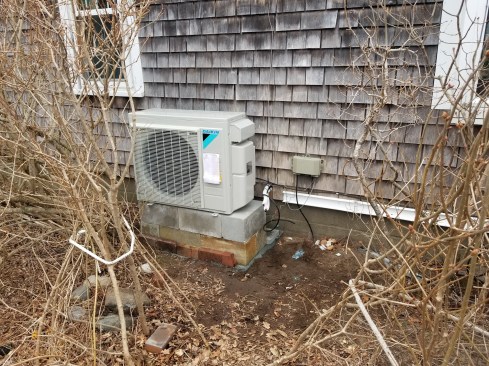

We opted on installing two units—one in the east end of the cottage to replace the ancient monster, and one in the west end, leaving the fireplace as a backup for ambiance. The minis would also double for AC during the two or so weeks every summer when the hot weather had us putting in window-mounted AC units. Again, realize that this is all happening before work on the new kitchen can begin.
After weighing our options, we decided that both inside units should run off the same outside condenser, which meant that we’d have to run the coolant lines to the west-end unit through the cottage crawlspace. Our mini-split installer, Mario, turned out to be a Jamaican gentleman who was easily 6 feet 6 inches tall (his company is cleverly named “Cool Runnings,” but Mario confessed to never sitting on a bobsled). To make the installation go more quickly, I volunteered—much to Mario’s relief—to do the crawlspace detail.
Two mini-splits that run off of this single outdoor compressor will be the new source of heat for the cottage. The fireplace insert will remain for ambiance and as a back up heat source. The minis will also provide AC for the cottage when needed.

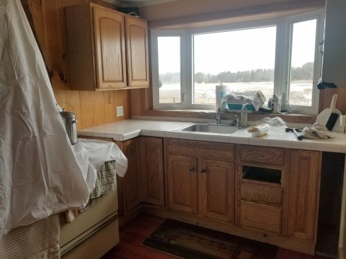

With a coating of snow on the marsh outside, the old kitchen awaits demolition inside.

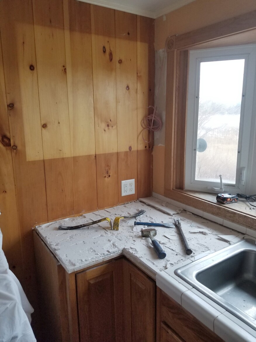

The first step was chipping the tile from the countertop. By taking care with the removal, the old cabinets could be repurposed for workshop storage.
Meanwhile back in the kitchen, we covered the new fridge and got ready for the demo work. I began by chipping off the old tile countertops, and then attacked the plywood underlayment and cabinets. I removed the old cabinets carefully and gave them to a friend who grabbed them to use in a new workshop he was building.

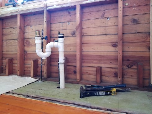

The original exit plumbing for the kitchen sink featured an S-trap and an air-admittance valve--both no nos in today's code. Removing the wall board and insulation to rerout the plumbing exposed these beautiful beaded pine sheathing boards original to the cottage from the 1940s.
The original exit plumbing for the kitchen sink featured an S-trap and an air-admittance valve–both no nos in today's code. Removing the wall board and insulation to rerout the plumbing exposed these beautiful beaded pine sheathing boards original to the cottage from the 1940s.

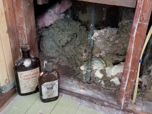

Removing blown-in insulation from around the tub in the adjacent bathroom, exposed two empty bottles stashed there by some former tradesman. One can only speculate as to the actual source of this unsavory time capsule.
When the bulk of the infested insulation had been removed, I once again vacuumed all the loose debris that had fallen. This time, the vacuuming exposed a strange dark shape of some sort coming out of the cellulose beside the tub. I stuck my finger in the cellulose and pulled out two empty whiskey bottles. I chuckled remembering John Carroll’s Backfill column a few months back in which he wrote about how he left a time capsule for folks to discover in the future. My guess is that this was the sort of time capsule that no one was supposed to uncover. I immediately began to wonder who had left the “gift” for me to discover: The plumbers who had installed the tub? The drywallers? Or maybe another tradesman who spent a lazy afternoon guzzling cheap booze while enjoying the views that the cottage had to offer?

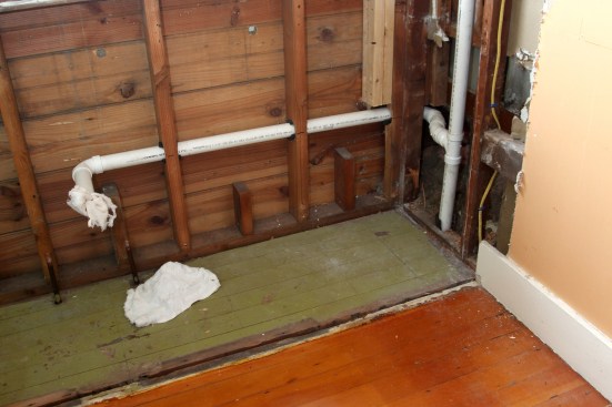

The new exit plumbing for the kitchen sink and dishwasher enters the chase behind the tub with a sweep 90, and then reverses slightly so that the plumbing avoids the floor framing below. The pipe from the top of the T-Wye is for the required plumbing vent.
The plumber arrived early on a Saturday morning. He laid out the exit plumbing and began drilling. Barely a half inch into the first stud, he hit a nail, and then hit nails on every single stud after that. When we got to the corner, the Forstner bit tore through the jack studs under the kitchen window and then hit a nail coming straight through from the other side. We did some creative drilling/gnawing work and finally broke through.

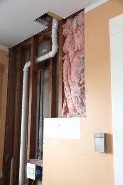

The vent pipe from the T-Wye enters the adjacent stud bay and then is routed through the ceiling next to one of the ceiling joists. Once above the loft floor over the kitchen, the vent diameter increases to 2 inches, the minimum legal size for an auxiliary vent where it penetrates the roof.
The plumber ran the vent coming out of the T-Wye through the upper plate in the neighboring stud bay. In the loft space directly above the plate, he increased the pipe diameter from 1 1/2 inches to 2 inches (minimum approved diameter for a secondary vent), just above the loft floor. While the plumber completed the hookup in the basement, I installed the upper length of the vent pipe along with the roof boot, working in the teeth of an icy northwest wind whipping across from the marsh.
