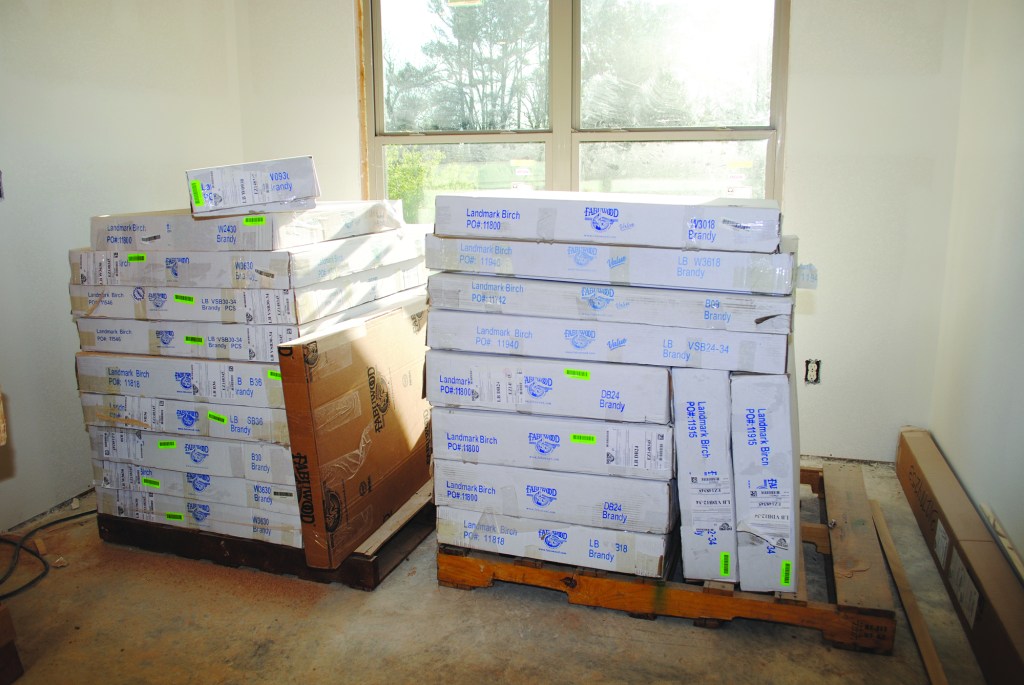

Kitchen on a Pallet
After contacting Custom Service Hardware, I sent the company a floor plan, from which it generated a layout complete with cabinet placement and computer renderings of how the kitchen would look after the cabinets were installed. After a couple of minor tweaks to the layout, I ordered the cabinets. The company promised to ship the order within a week, and a trucking company delivered it to the site about 10 days after I placed the order—exactly as promised. I was amazed that the entire kitchen fit on a couple of pallets, each cabinet in its own box.

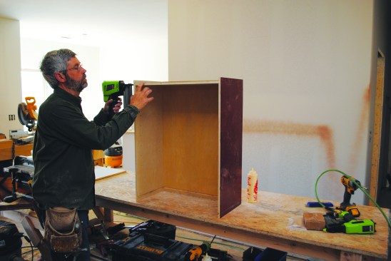

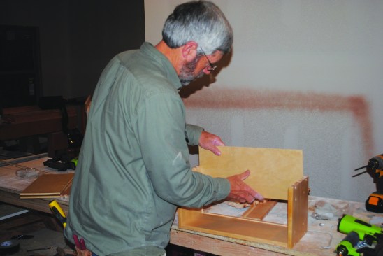

Because this was my first experience with RTA cabinets, I had no idea how long the assembly process would take. I opened the first box and was a little surprised that there were no instructions of any kind (although Custom Service Hardware does have videos on its website). Some RTA cabinets use knock-down connectors, but the cabinets that I bought just nail and screw together.
First, the author nails the cabinet back into the sides.
Then he slides the bottom into precut dadoes.
Putting the Cabinets Together

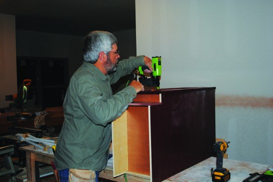

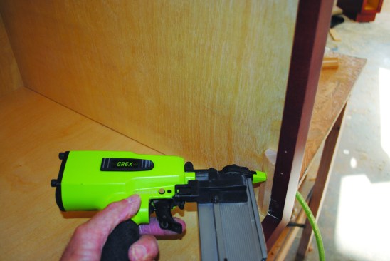

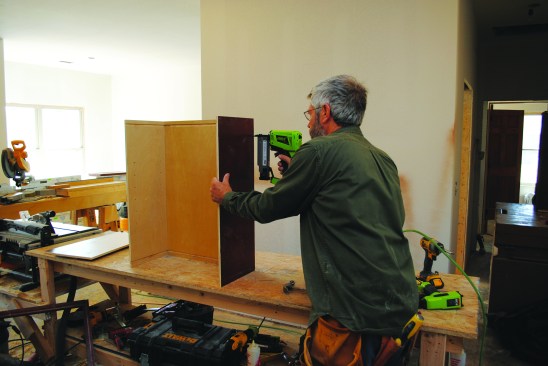

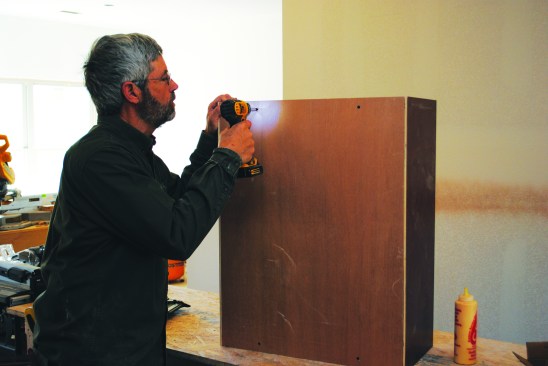

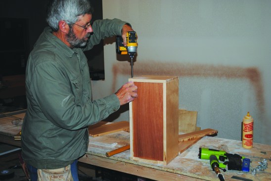

I started with the wall cabinets. All of the cabinets came with 1/2-inch-plywood backs, and I nailed the sides of each wall cabinet to its back with 18-gauge brads, using the rabbets milled into the sides. The sides also had dadoes to receive the bottom and the top, so I slid those pieces into their dadoes and nailed them in place.
The cabinet backs screw to the cabinet bottoms through predrilled holes.
Next I screwed through the back into both the top and bottom. That step was pretty easy because the back came predrilled with pilot holes, and the hardware package that came with each cabinet contained all the needed screws. I also marked a guideline across the back and drove a few brads between the screws.

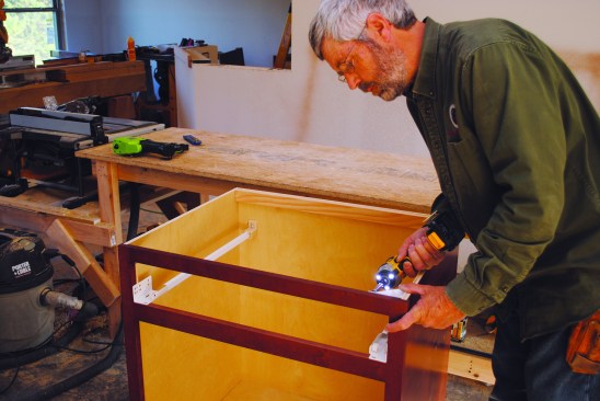

The base cabinets went together in similar fashion except that they didn’t have tops and they did have toekicks. The only things I added to the cabinets that weren’t included in the kit were some small pine cleats to reinforce the cabinet backs for the attachment screws. I added just a single 1×2 cleat at the top of each cabinet. On the lower base cabinets, the cleat was glued and nailed directly to the back, flush with the top. On the upper cabinets, I nailed down through the top to secure the cleat. Again I probably went a little overboard, but the cleats were easy to cut and install, and I used only one 10-foot 1×12 to make the cleats for the whole kitchen.
The author adds a cleat (not included in the parts kit) to strengthen the back for installation.

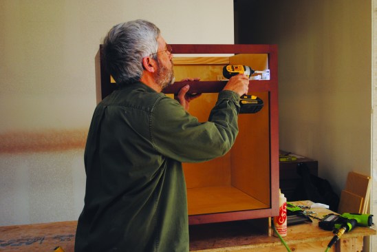

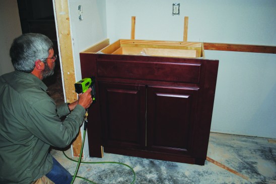

He tacks the finished face frames to the cabinet fronts.

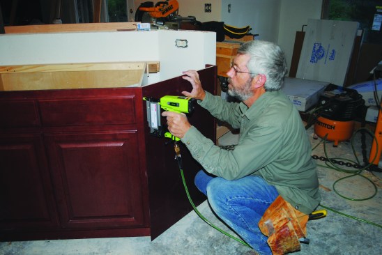

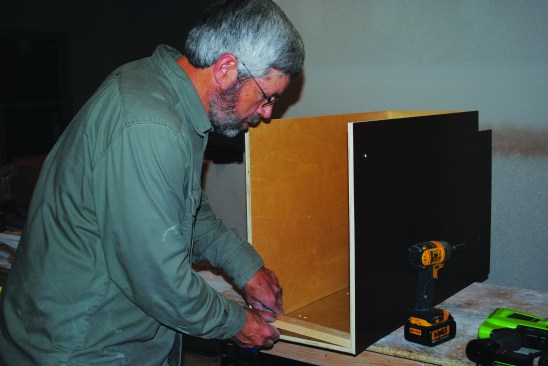

The final step in assembling the cabinet boxes was gluing and attaching the face frame to each box. Dadoes in the back of each face frame facilitated this step and kept the box lined up with the frame. After running a bead of glue along on the front edges of the box, I shot a few headless pins through from the front. The real strength of the joint came from manufacturer-supplied glue blocks ripped with a 45-degree face. I installed these blocks between the sides and the face frame, with the angled face making it possible to nail into both the cabinet-box side and the back of the face frame. Once the glue dried, this configuration made for a very strong connection between cabinet box and face frame.
Glue blocks reinforce the attachment.

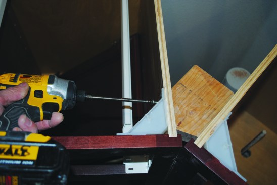

Base cabinets receive plastic corner brackets that help to keep the cabinets square while they are installed.
The base cabinets required a couple of additional steps. First I nailed on the toekick board along the bottom of each base cabinet. The base cabinets also received a pair of plastic brackets installed at the top front between the sides and the face frame to help keep the boxes square as they were being installed.

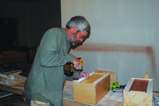

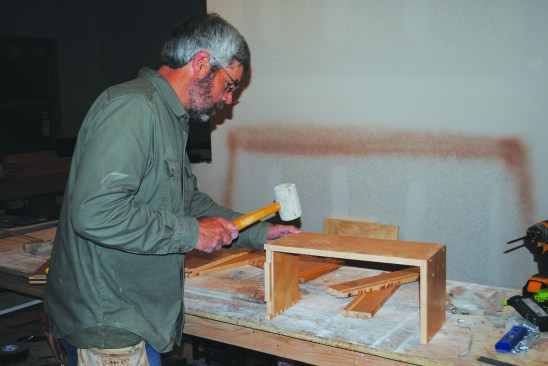

RTA Drawers
I found that assembling the drawers was remarkably simple too. The sides dovetailed with the front and back, so I just used a rubber mallet to tap the front and back to one of the sides. Then I slid in the drawer bottom and tapped in the other side.
Dovetailed cabinet drawers also have to be assembled. The author taps and tacks the front, back, and one side together.
Then he slides the drawer bottom in and taps the other side into place.
The dovetails fit together almost perfectly, so I did not glue the dovetail joints together. I did shoot a headless brad through each dovetail pin, just to be on the safe side, and then ran screws through the predrilled holes to hold the drawers together. After assembling the drawers, I set the finished drawer fronts aside to attach after the doors below them were installed.
Screws through the front and back hold the assembly together.
The drawer slides attach to the bottom via predrilled holes.

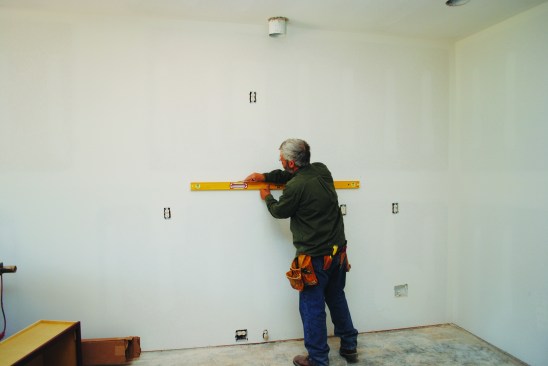

I’ve seen many different strategies for installing kitchen cabinets, but I believe that it’s easier to hang the upper cabinets first. I hate having to reach over base cabinets to screw the upper cabinets in place. Because this kitchen had 9-foot ceilings and the upper cabinets were only 30 inches tall, I decided to set the height of the upper cabinets 20 inches above my finished countertop, instead of 18 inches, as I usually do.
The kitchen layout consisted of cabinets along two opposing walls—one side with the stove and refrigerator and the other with the sink and dishwasher. On the stove side, I drew a level line 20 inches above the height of the countertop. I screwed a temporary cleat below the line to set the wall cabinets on until I screwed them into place (a backsplash covered the screw holes for the cleat).

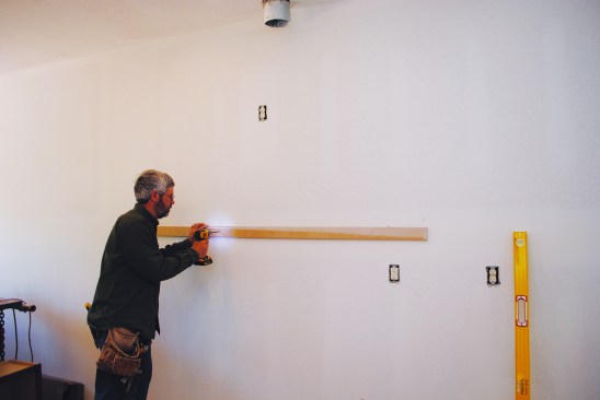

The author draws a level line on the wall at the proper height.
Then he screws a temporary cleat to the wall on the line.

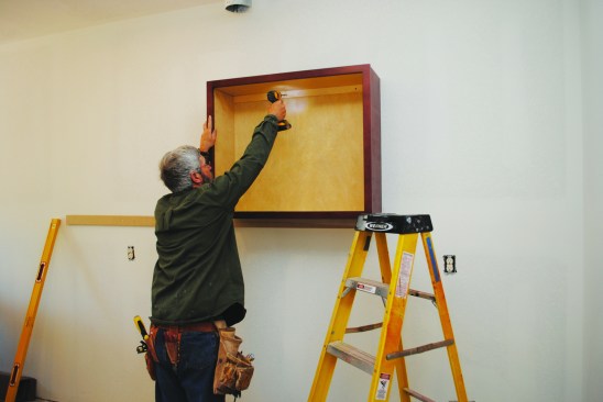

That run of cabinets started with the refrigerator on one end, so I pulled the cabinet layout from there, working my way toward the opposite end. I measured over the width of the cabinet above the fridge, plus a filler strip along the wall, which would keep the handle from hitting the wall and let the fridge door open wide enough for any drawers inside to pull out properly. I marked that distance over the cleat where the main run of wall cabinets would start.
I set the first cabinet on the cleat and attached it to the wall—initially with just a couple of screws, so that I could adjust them in or out slightly to align the face frames. To join cabinets together, I held the face frames in line with K-clamps. Then I drilled pilot holes and drove a couple of 2 1/2-inch screws between the face frames. Once the face frames were screwed together, I added more long screws to secure the cabinets permanently to the wall and then removed the temporary cleat.
After marking the layout on the cleat, he positions the first cabinet and fastens it to the wall using screws.
Then he aligns the face frames and screws them together, and permanently screws the cabinets to the wall. Cabinet doors are attached last.

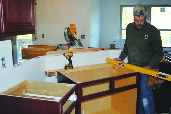

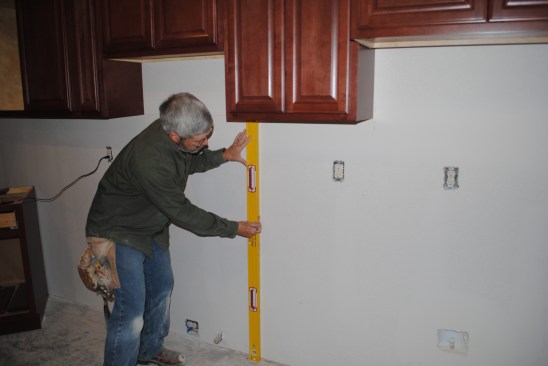

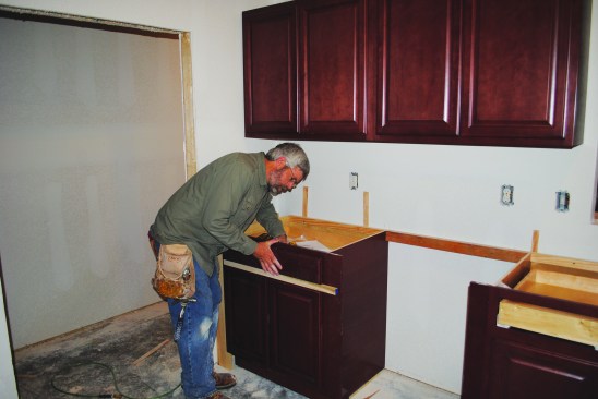

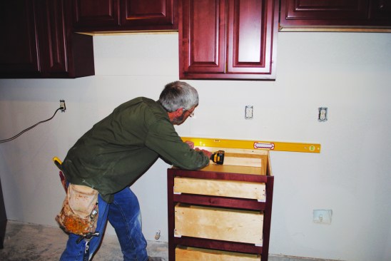

The base cabinets along the fridge wall were the same widths as the wall cabinets above, so I just plumbed down to position them. I shimmed the cabinets level and screwed them to the wall through the cleats I’d installed inside each of the cabinets. Where two base cabinets joined in a line, I clamped their face frames flush and joined them together with screws. I also put shims between the sides of the cabinets close to the wall and screwed them together for added strength.
A plumb line positions the base cabinets.
Once the base cabinets are leveled, the author secures them to the wall with screws.
As with the wall cabinets, the face frames are lined up and screwed together. Shims and screws keep adjacent cabinets spaced properly and hold them together at the back.

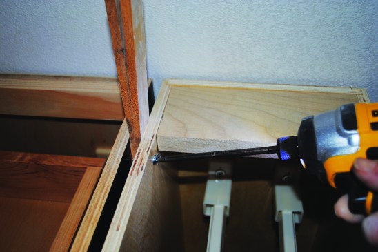

On the opposite wall, I wanted to keep the sink centered on a half-wall that jutted out at a 45-degree angle, so I customized the placement and the fit of the base cabinets accordingly. First I installed the wall cabinets as on the other wall. For the face frames of the sink base and the adjacent base cabinet to meet properly, the sink base had to step off the angled wall by about 6 inches, so I screwed a stack of 2-by cleats to the wall. Then it was a matter of putting the sink base in place along with the adjacent cabinet and shimming them level until the face frames met perfectly.
Stacked cleats build out the cabinet on this angled wall.
Angled blocks join neighboring cabinets.
Because there was no way to screw through the face frames, I fashioned angled blocks to join the two cabinets through their sides. On the other side of the sink base, I used a finished end panel to return the cabinet at 45 degrees to the half-wall.

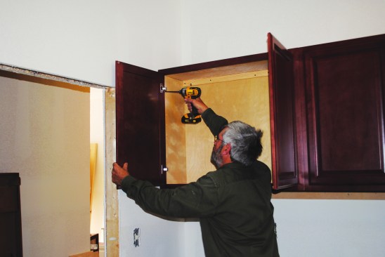

I’d already hung the upper cabinet doors, so I turned to hanging the base cabinet doors and adjusting them. With the pilot holes in the face frames, that process went very quickly. To mount the drawer fronts, I set a spacer on top of the doors. After lining one side of the drawer front with the edge of the door below, I attached the drawer front to the drawer with screws.
