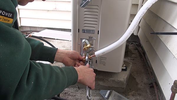

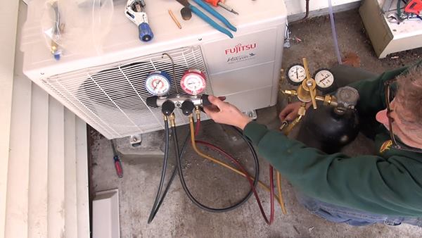

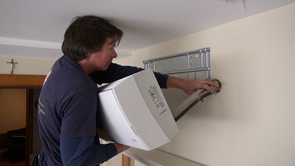

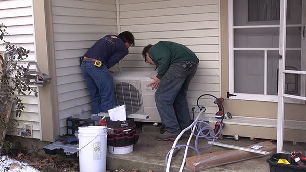

The heat pump system shown here, a Fujitsu Halcyon AOU12RLS2, retails online for about $1,600 (not counting professional installation), and is rated at 12,000 Btu for heating. When outdoor temperatures drop below 20°F, the heating capacity decreases. But the unit can still supply some heat at outdoor temperatures of -5°F. The system comes with outdoor unit containing the compressor, controls, and a reserve tank containing enough R-410a refrigerant to charge 49 feet of refrigerant lines as well as the wall-mounted indoor unit’s heating and cooling coil.

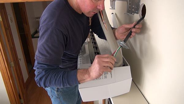

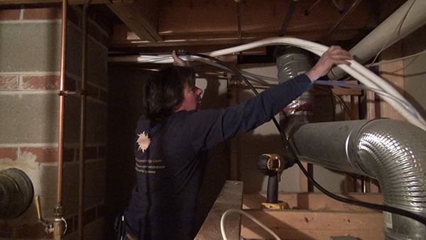

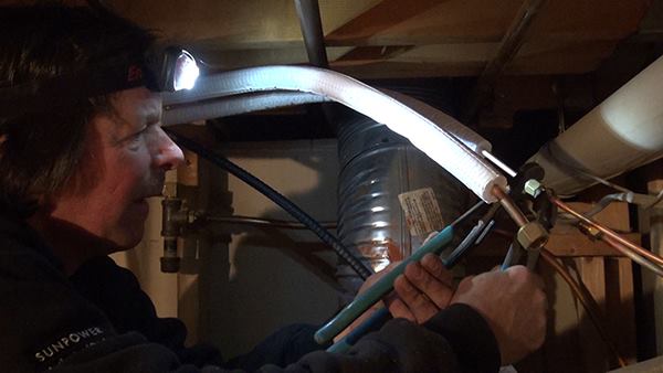

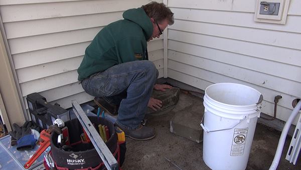

Four lines connect the indoor unit to the outdoor unit: two refrigerant lines (one for liquid coolant and one for vapor); a power line for the indoor unit’s fan; and a condensate line that drains any water vapor that may condense on the indoor unit’s coil when the system is operating in cooling mode.

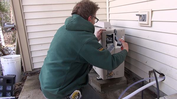

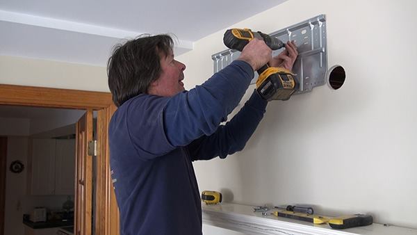

A system like this takes the crew one or two days to install, including the wiring and refrigerant line installation. The two technicians shown in this slideshow are master plumbers with additional training in refrigeration technology. They also have the skill to run the rough wiring for the system, but a licensed electrician will be needed to inspect the installation and hook up to the home’s electrical panel.
