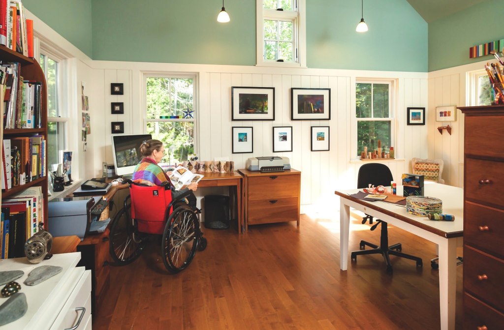

This project room features work surfaces with knee space below, a clear circulation path, a floor free of area rugs and other obstructions, and plenty of natural light.
Kathy Tarantola

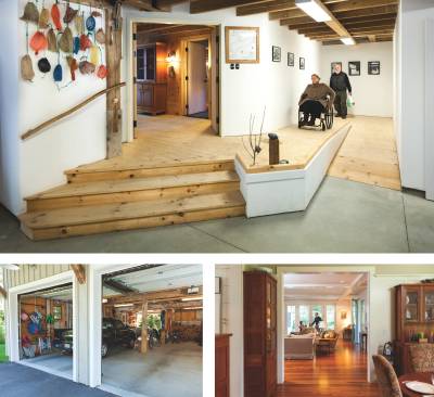

An indoor ramp makes life easier for anyone who finds stairs challenging. A covered entry protects those who need extra time to exit a car (below, left). Threshold-free openings make interiors accessible (below, right).
Kathy Tarantola

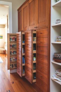

Roll-out shelves put essential items within easy reach.
Kathy Tarantola

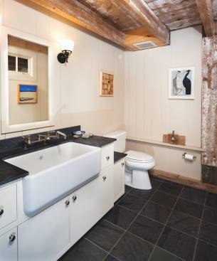

Low shelves flanking the toilet take the place of grab bars. A swing-out faucet with lever handles is practical as well as accessible.
Kathy Tarantola

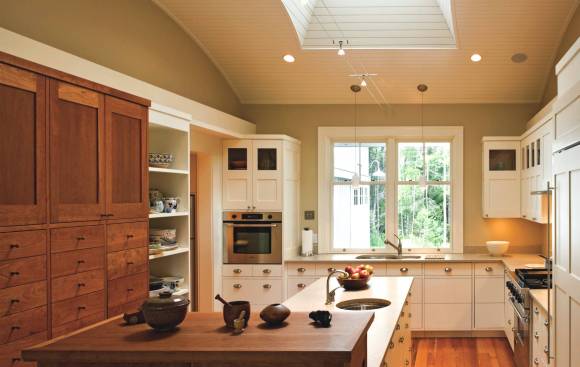

A large central skylight makes this kitchen a magnet for guests and is a boon for cooks with aging eyes.
Kathy Tarantola
