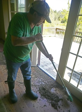

Arriving on site, the author found a killing field of bees perpetrated by a DIY attempt to rid the house of bees with an insect bomb.

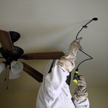

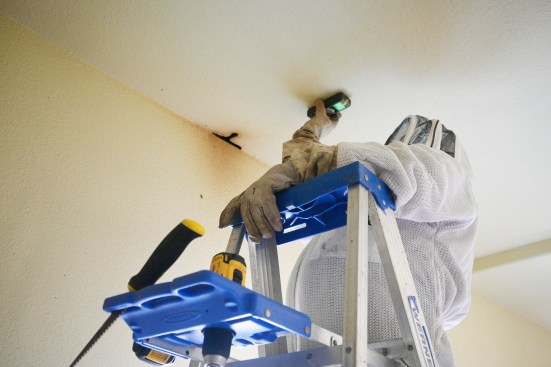

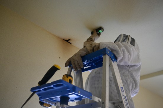

Nanette used a thermal imaging camera to detect a heat signature and determined the hive was in the ceiling. We decided to wait until the weather cooled so the bees would be calmer and the work less uncomfortable, since the house was in Houston and lacked air conditioning.

Opening up a ceiling isn’t difficult for a contractor like me. However, beekeepers, though they might know a lot about insects, don’t necessarily know much about building hazards like electrical wiring or plumbing, and cutting into a house isn’t part of their job. Laws differ across areas, so it’s always best to hire a professional with the right equipment and knowledge to do the removal and follow any required protocols. A licensed professional should always handle opening building parts for hive access.

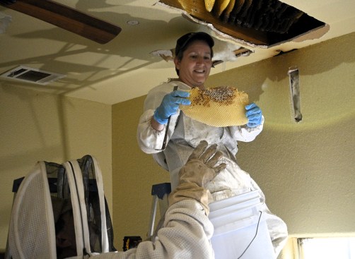

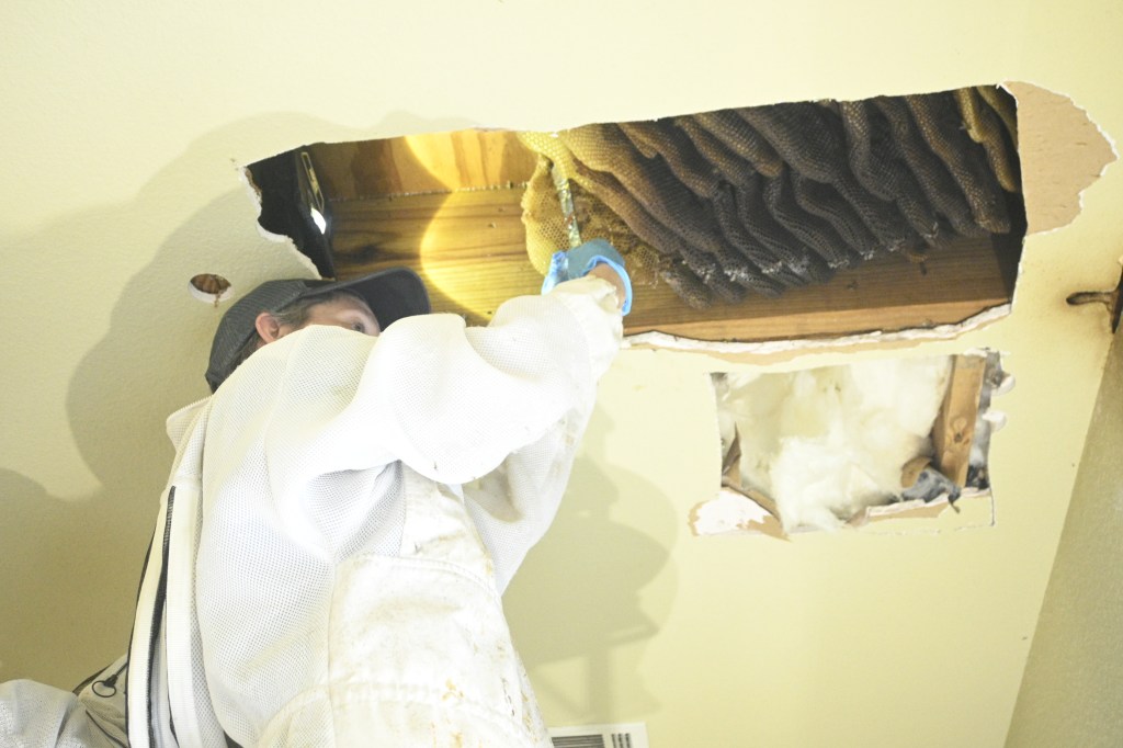

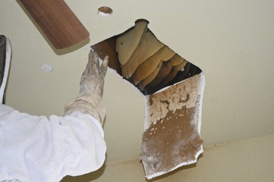

As the first sheet of drywall peeled off, I caught my first glimpse of the hive. It didn’t look as I expected; I initially thought it was foam insulation. Honeycombs often hang vertically; in this case, they were suspended from under the subfloor of the second story. The combs resembled radiator panels designed for air circulation in summer and heat preservation in winter. Looking closer, I noticed the hexagonal structure of the individual cells. Bees build hexagons because they mesh together perfectly, like an endless puzzle, leaving no gaps between cells. It was time to let the expert take over.

Though we exposed the hive and shook the structure while cutting, the bees remained surprisingly calm. While there are about 4,000 native bee species in the United States—800 of them in Texas—there was no doubt about the species here: the Western Honeybee, Apis mellifera, the only bee in the country that produces honey. And there was plenty of it. As Nanette carefully scraped each panel from the subfloor, honey poured down her hands and arms onto the ladder rungs and the floor. It’s a sweet but messy job.
Nanette removed her veil because the bees seemed unbothered. She complained about the heat and preferred the occasional sting over eight hours of sweating in a hood while carefully working overhead to remove each panel. At one point, she got stung. Some bees can become aggressive and swarm, but bees generally sting only as a last resort. After a worker bee stings a mammal, the barbed stinger can get stuck in the animal’s skin, tearing loose from the bee’s abdomen and leading to her death within minutes. It’s a kamikaze mission. Bee venom contains histamines and proteins that can cause allergic reactions in some people, but, for most, a sting is just mild discomfort.

Working with licensed bee removal experts, such as master beekeepers, is essential for handling hive removal’s structural and ecological challenges. These experts use tools like thermal cameras and fiber-optic scopes to safely locate hives without damaging other parts of the building. Beekeepers also help prevent DIY efforts that could worsen the problem and lead to unexpected repair expenses.

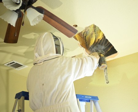

When a bee stings, it releases alarm pheromones that attract other bees and prompt them to defend the hive. An angry swarm would have interrupted our work. To keep things peaceful, Nanette asked Scott to bring the smoker, a device that looks like an old oil can with a bellows attached. Smoke is produced in a fire chamber using wood chips, dried leaves, or grasses. Scott climbed the ladder and pumped the bellows, releasing smoke onto the hive. Soon, the bees’ buzzing quieted, and the threat of an angry swarm diminished.
Scott Davis uses a smoker to calm the bees during removal.

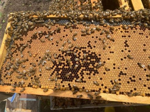

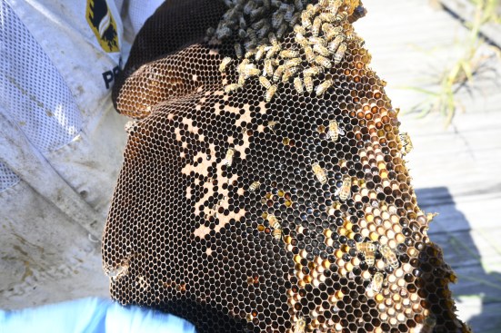

As Nanette continued removing honeycomb panels, she commented on their condition. She pointed out brood cells covered with a wax lid. Healthy broods are uniform, with brood cells lined up neatly, covering large sections of the comb. Queens are careful about how they lay eggs when everything is healthy. A scattered or “shotgun” pattern shows an unhealthy brood. Nanette shook her head, doubting the queen had survived the poisoning. She pointed to small peanut-shaped structures at the edges of some combs, explaining these are “practice queen chambers.” The bees build these chambers to practice their skills, even if no queen will use them.
Nanette asked us to step outside and look through a honeycomb into the sun to see the details of the symmetrical hexagonal pattern, which perfectly combines architectural form and function. Despite the honeycomb’s fragile appearance, the interlocking hexagonal cells create a strong structure. It’s surprisingly heavy. Charles Darwin once observed that bees’ ability to build perfect honeycombs was “the most wonderful of all known instincts.” Each hexagonal cell is so precisely made and neatly arranged that it’s a visual delight.

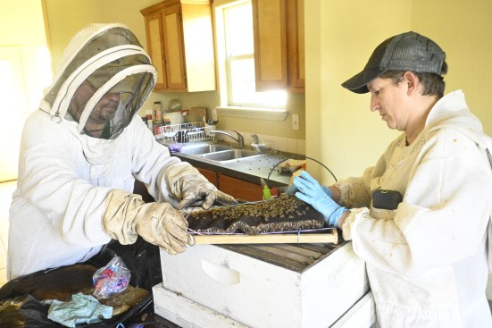

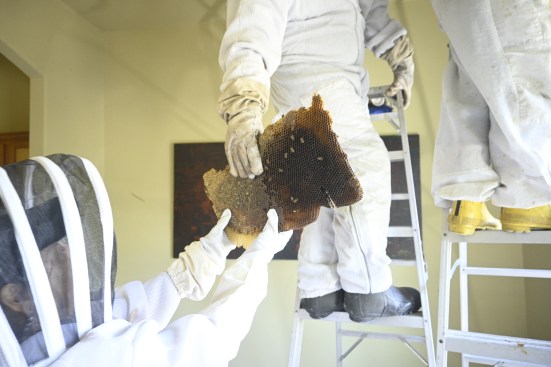

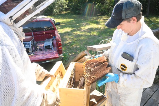

After removing the panels, Nanette and Scott cut and placed them in wooden frames, securing each with rubber bands. These frames slipped into a slotted box for transport.
Once she placed all the panels safely in their frames, Nanette carefully scraped off all the wax and honey from the underside of the subfloor and joists. Any leftover residue could attract the bees that weren’t in the hive; most were out foraging, so many would return looking for their home. With the hive gone, I could clearly see where the bees had entered through a gap between the cantilevered balcony joists and the floor framing. They had built their hive in the spot where the builder forgot to fill the joist bay with insulation. I sealed this crack with caulk and made a mental note: Always seal around joists and never forget to insulate.

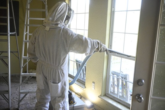

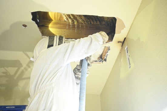

To complete the extraction, Scott used a “Colorado Bee Vac” to gently suck the bees through a tube into a screened box with plenty of ventilation. It felt like an endless task; no matter how many bees Scott removed, new ones kept flying into the house through cracks. Eventually, nearly all the bees were gone, except for the thousands gathered outside, attracted by the smell of honey. Soon, the panel box and the bee-vac box were loaded onto the back of the beekeepers’ pickup truck, along with the rest of the equipment, and we were ready to lock up and move the bees to their new home. Nanette and Scott took care that no bees got into the cab, as driving with a swarm could be dangerous.

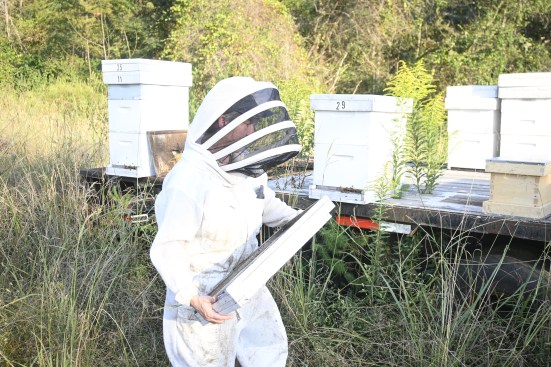

After about a half-hour drive, we followed the beekeepers to a field where several hives were stacked on trailers, elevated above the ground to prevent flooding. The pair suited up again, as dropping bees into their new home can provoke anger and swarming. We kept a safe distance and observed.

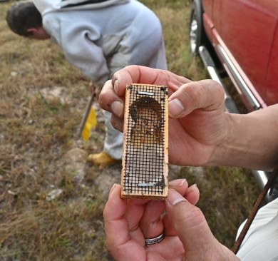

Introducing a new queen is delicate because the bees may kill her. The new queen is placed in a small cage with three worker bees as attendants. The cage protects her while the rest of the colony gets used to her pheromones. A small hole blocked with hard candy at one end of the queen’s cage takes the bees about five days to chew through. This period allows the colony to accept her scent. Once the candy is gone, the queen is released to start laying eggs, and if everything goes smoothly, the colony is re-established.
