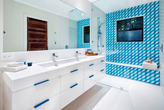

Bright blue tiles and coordinating drawer pulls provide a pop of color in this bathroom remodel by Mark Evans
Courtesy of CG&S Design-Build
