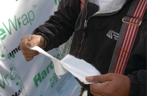

If housewrap tears easily, don't use it.
But there are solutions. Building science has shown us what to do with water that leaks behind wall claddings. Proper installation of a housewrap—also known as a water-resistive barrier (WRB)—preferably with a rainscreen behind the wall cladding, enables us to build resilient homes that will last for generations

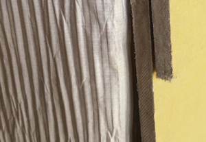

The textured surface on this housewrap, made by Tyvek, creates small vertical channels between the back of the cladding and the sheathing, allowing moisture to drain to the ground. It needs to be oriented properly when installed.

I like to use a housewrap that has a textured surface as the first defense for draining out moisture that infiltrates behind wall claddings. The small gap it creates between the back surface of the cladding and the sheathing allows water to drain away to the ground. Manufacturers use a variety of patterns and technologies to hold the siding away from the sheathing when it's installed.
Dupont, the parent company of Tyvek, manufactures a family of small-gap housewraps. Two that I use are Tyvek Drainwrap and Commercial Wrap D. The main differences between them are that Commercial Wrap D is slightly tougher, and it has a longer UV-exposure time, so it will last longer if it's going to be a while before you install siding. Both have a slight, almost crinkled corrugation, which when installed properly creates vertical channels for water to run out. Regardless of how tightly the siding is attached to the sheathing, Drainwrap and Commercial Wrap D create enough of a space between the back of the siding and the wall for water to drain away.
