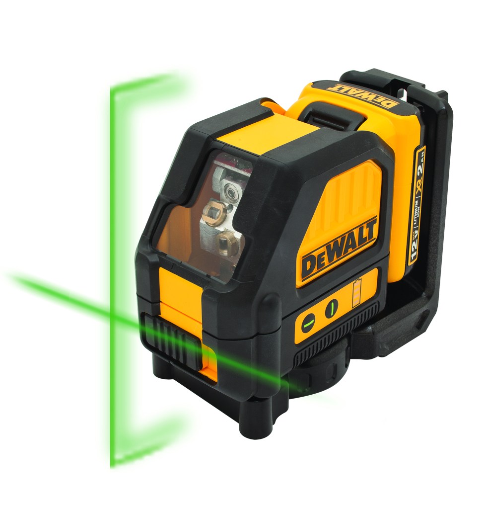

Cross-line lasers project a horizontal and vertical line either independently or together so they intersect. According to DeWalt, the horizontal line of the DW088LG fans out at least 100 degrees and the vertical line at least 130 degrees.
Like most competing lasers, the DW088LG uses an internal pendulum to self-level. The base of the laser must be within about 4 degrees of level for the pendulum to work. If the inclination is between 4 and 10 degrees, the beams flash once per second to indicate that you’re outside the self-leveling range. Exceed 10 degrees, and the lines quickly blink three times about every six seconds, projecting uninterrupted layout lines for five seconds between each series of blinks. According to DeWalt, the reduced blinking is designed to be less distracting for when you tilt your laser to project sloped layout lines, such as for setting stair rails or angled tile. To help prevent shock damage, the pendulum automatically locks when you switch off the tool.

The laser comes in a kit that includes a drop-ceiling attachment, a blow-mold case, a 12V MAX 2-amp-hour battery, and a charger.
Despite the breakthrough in green-diode technology, green lasers still draw a lot more power than red ones. While the DW088LR red laser delivers 12 to 27 hours of runtime on AA batteries, the DW088LG would deliver only 4 1⁄2 to 6 1⁄2 hours of runtime on AAs. With a 12V MAX battery, on the other hand, it delivers 8 to 14 hours. This battery takes about 1 1⁄2 hours to fully recharge, but can power the laser all day on one charge, so that’s a small issue. There’s an excellent four-bar battery gauge on board.

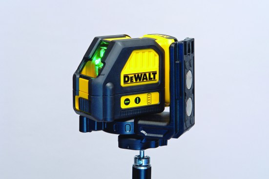

The laser is mounted to an L-shaped bracket that lets it rotate 360 degrees on its vertical axis (see photo, above), which can be a blessing for aiming layout lines. The bracket has 1⁄4-20 and 5⁄8-11 sockets on the bottom for tripods and laser poles, and two mighty rare-earth magnets on the back that stick to a metal strip on the drop-ceiling attachment and to other ferrous metal. The bracket can also hang from a nail or screw.
The laser is built to be exceptionally rugged. DeWalt says it tested shock resistance by dropping it onto concrete from a height of 1 1⁄2 to 2 meters with the pendulum locked. It also has an Ingress Protection rating of IP65, which means that it’s dust-proof and won’t be damaged by rain.
