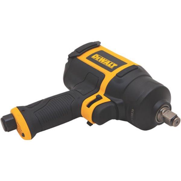

1/2” Impact Wrench (DWMT79773L)
Capable of delivering 650 ft-lbs of torque the DWMT79773L has the power to free frozen bolts and perform heavy-duty fastening. An adjustable power regulator allows the user to switch between full, medium, or low power settings. The high-impact composite body reduces the weight of the tool while protecting the user’s hand from cold air passing through the handle. Exhaust is directed away from the user by routing it through an exhaust port on the bottom of the handle.
Free speed: 7,500 RPM Max Torque: 650 ft-lbs
Blows/min: 1,100
Maximum air flow: 5.9 CFM @ 90 PSI
Air inlet: 1/4”
Weight: 4.63 lbs.
Country of origin: China
Price: $170
