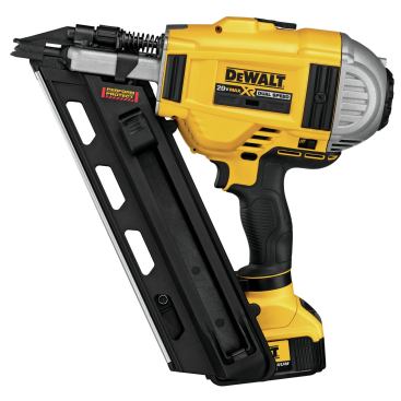

Powered by DeWalt’s 20V Max 4-amp-hour battery, the DCN692 has a brushless motor, drives paper-tape clipped-head and offset round-head nails from 2 to 3 1/2 inches long, is supposed to sink up to 700 nails per charge, and has dry-fire lockout. Unlike its gas-powered rivals, the DeWalt nailer can bump-fire in addition to firing in a sequential mode.
The rotor of the brushless motor doubles as a flywheel, propelling the driver blade to sink each nail. Several cordless finish nailers substitute flywheel power for internal combustion, but the DCN690 and DCN692 are the first framing nailers to do so.

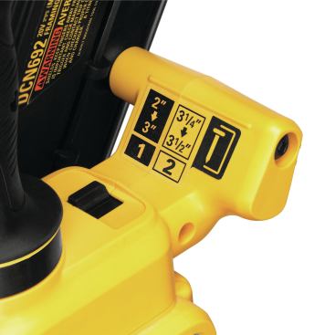

The dual speeds of the DCN692 let you choose the best flywheel speed for the job. Speed 1 is tuned for driving 2-inch to 3-inch nails, and it accelerates the bump-firing of these fasteners while extending the battery runtime. Longer fasteners are driven at speed 2. Unlike compressed air, which delivers instant power, the flywheel goes from 0 rpm to firing speed in 0.5 to 0.7 seconds.

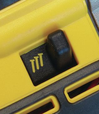

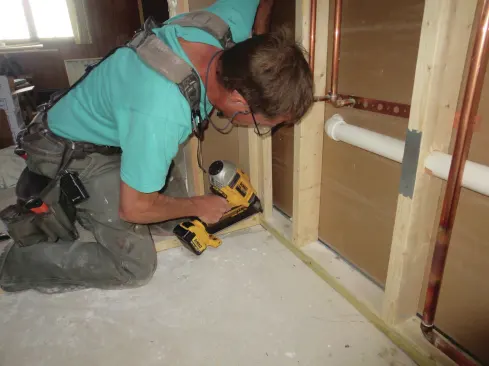

The DCN692 weighs 9.1 pounds with the battery installed, while the gas-powered models all weigh less than 8 pounds. Despite the extra weight, the DeWalt is comfortable, well-balanced, and easy to use. It’s 13 3/4 inches tall, which helps when nailing in tight spaces, and has an aggressive nose for easy toenailing. You can change the mode from sequential to bump action at the flip of a switch, and the gun hasn’t double-fired even in bump mode. It has a stall-release lever that’s supposed to help reset the driver blade if the blade fails to return to the firing position after driving a nail, but I can’t comment on it because the tool has yet to stall. I like the belt/rafter hook, which rotates to accommodate lefties or righties and parks beneath the handle when you don’t need it. And of course there is no burning-fuel smell, which some crew members really appreciate.
But like the gas-fired models I’ve tried, the DeWalt just doesn’t have enough power to sink our spikes consistently. Working in a coastal environment with high-wind codes, I exclusively use galvanized round-head framing nails. If I’m deliberate, the tool will dependably drive our 3 1/4 -inch nails all the way into green Douglas fir or kiln-dried spruce. But it leaves some of the nails proud when firing into seasoned wood, engineered lumber, and much of the other material we work with.
I did learn two techniques that help. First, I wait until the flywheel is spinning at full speed before firing. The gun won’t fire until the flywheel is almost up to speed anyway, but you gain a power boost by pausing for that extra moment. Second, I push hard on the gun to minimize power loss to the recoil. The instruction manual says you need to allow some recoil, but if you allow too much, the gun won’t set spikes at all. Unfortunately, my first technique slows me down, and the second tires me out. Speed 1 delivers enough power to sink our 2 3/8-inch ring-shank sheathing nails, but our pneumatic nailers are much faster for nailing off sheathing and subfloors because we don’t have to wait for the flywheel.
