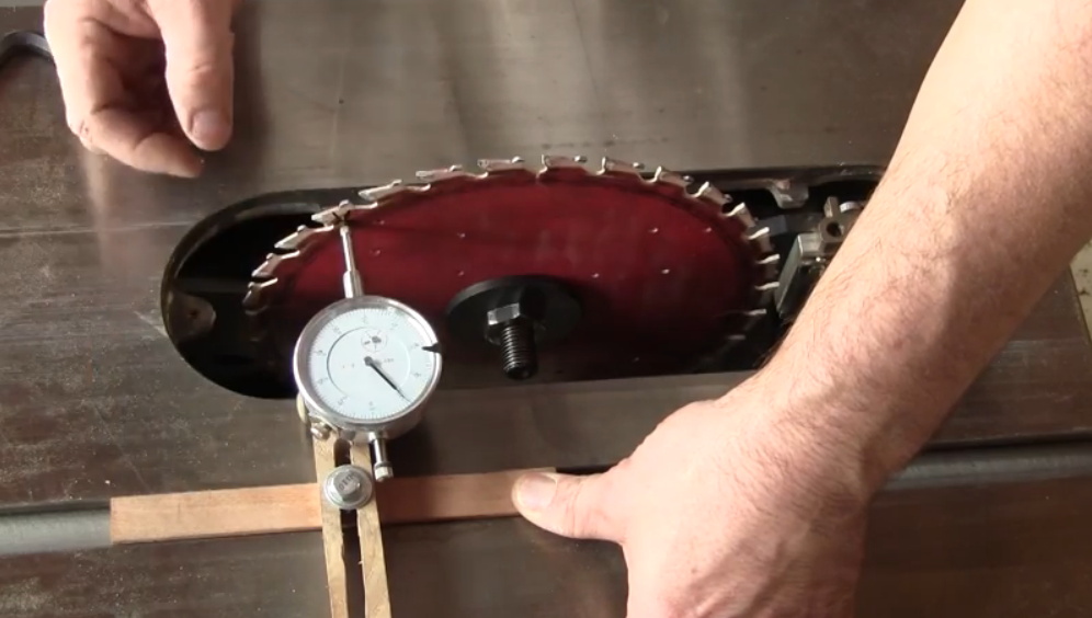

In the video below, Canadian woodworker Allain Vaillancourt does a rehab job on his cabinet saw that would make any tradesman proud. He cleans the trunion mechanism, reinstalls the top, and does an excellent job aligning the blade, fence, and bevel stops.
When a dial indicator appeared on the screen I knew all was right with the world, because with that tool and the right technique you can get just about anything to within thousandths of an inch of where it belongs. Vaillancourt uses one (3:35) to measure the distance between blade and miter slot while tweaking the alignment of the trunion; he doesn’t say how close he gets, but you can tell from the needle that it’s pretty much dead on. He uses a similar technique (6:10) while adjusting the fence parallel to the miter slots—so it too is parallel to the blade.
