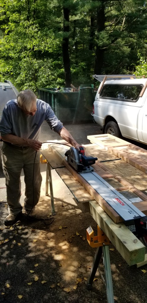

The author rips down an expensive and mis-ordered mahogany sidelight with the Bosch GKT13-225.

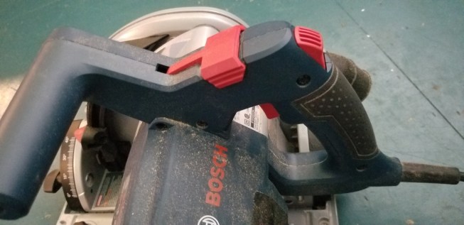

With the Bosch, making a cut is a two-step process; to fire up the motor, you first depress a safety switch with your thumb (which also releases the plunge lock on the saw) and then pull the trigger switch. I found it equally easy to perform these operations right- or left-handed.
Most of the moving parts are where you want them. The forward red bit locks the saw in the right place to change the blade, the red bit behind that one unlocks the plunge mechanism and the trigger, and the red trigger makes the blade spin.

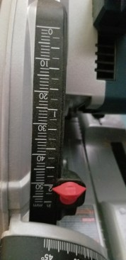

Depth of cut is quickly set using a sliding detent. The depth scale is in both metric and inches, and the depth indicator rotates to two positions; one for using the saw with the track and one for without the track. Although it’s only a 6 ½-inch blade, the maximum depth of cut is 2 ½ inches. The maximum bevel angle is 47 degrees, with a stop set at 45 degrees to keep you out of trouble.

Which brings me to the tracks. Here’s the difference. Festool’s joining plates are small compared with Bosch’s, and in my experience, they don’t always lock two sections of track together as well as I’d like. Bosch’s joining plates are about an inch and a half wide, providing plenty of alignment meat. Hex-wrench-operated cams lock the plates to the tracks, and the resulting joint is bombproof. (I’m told that Bosch’s track is identical to Mafell’s, but I haven’t confirmed that.) The plates have a different profile on each edge and only fit in the tracks one way. Well, that’s not strictly true—they can be forced in the wrong way. Don’t ask how I know.
The depth scale is in both millimeters and inches. The red indicator can be set in one of two positions, for use without the track ...
... or with the track.
When used correctly, they slip in and then lock very easily. The rubber zero-clearance splinter guard works well, both for aligning the track and for keeping cuts smooth. Replacements are available for when you inevitably beat yours up.
