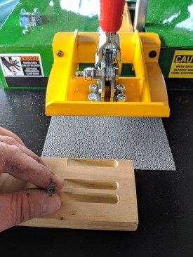

The Castle uses a rather unique setup to cut its pocket holes, using two Bosch routers. This one cuts the pocket and this one drills the pilot hole. You simply push the lever forward to cut the pocket and pull it back to drill the pilot hole. The whole process takes just a few seconds with repeatability that you just can’t get with a manual jig.

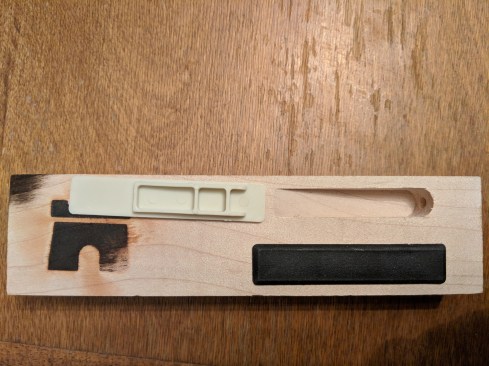

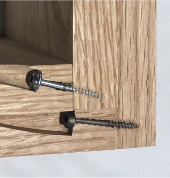

If you’re only used to the Kreg style of pocket holes, you’ll find another feature to love about the Castle: The holes are cut at an angle less than half (6 degrees vs.15 degrees) that of the Kreg. With that change, you’re not only more in plane with your mating piece—lowering the chance of the two slipping apart when screwing—but you also leave more wood fiber surrounding the screw. This translates to a stronger joint. Castle offers several styles of precut plugs for these holes, including an easily removable plastic plug that is actually quite attractive.
