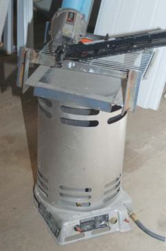

A house under construction harbors a lot of moisture; if you bring a very cold tool inside, moisture will condense (or even freeze) on the tool just as it will on eyeglasses. If the tool is electric and the switch or armature gets wet, it could short out when you turn it on. And with guns, the internal parts tend to stick if the housing frosts over. To prevent these problems, try not to use a tool until it's had time to warm up and dry. It'll be dry in 20 minutes to an hour if you put it near a fan or a heater. I keep an electric hot-air gun in my trailer for just this purpose.
When I'm working in a warm place, I try to leave my tools there until the job is done so that the tools and the environment are the same temperature. The reverse is also true: If I'm working in the cold I try to leave my tools in the cold. If you take a nail gun from a warm, moist building out into very cold weather, the moisture inside the gun will condense and freeze. The tool could then become clogged with frost, and the O-rings could freeze to the sides of the cylinder and be damaged when you fire a nail. I once took a gun apart and found half an O-ring still frozen to the cylinder wall; it reminded me of what happens when it's below zero and a kid puts his tongue on a frosty piece of metal.

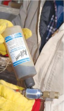

When temperatures dip below 20°F, I lubricate my nail guns with Kilfrost 400 (www.kilfrost.com), a synthetic lubricant and de-icer designed specifically for pneumatic tools. Kilfrost 400 melts any ice in the gun and prevents refreezing. I've also had good results with a similar product called Coilhose ATLW (www.coilhose.com).
These products are not additives, so they should not be mixed with other lubricants. Moreover, you should use them only in the cold, because they do a poor job lubricating nail guns in temperatures above 30°F or 40°F.
Clogged hoses. Air hoses usually freeze at the fittings, so if a hose frosts up we put a few drops of Kilfrost into the fittings and that usually opens things up. Then we blow out the hose to prevent water and excess lubricant from going into the gun.

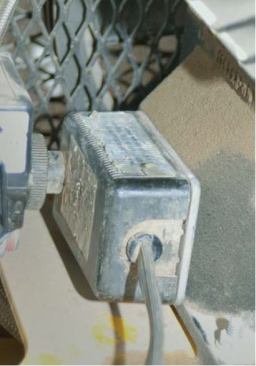

Compressors. My big 220-volt compressor has little trouble starting in the cold — even at zero degrees. I have a harder time getting my smaller, 110-volt model to start, so I give it some help by putting a magnetic oil-pan heater on the oil reservoir. After about a half hour of heating, the compressor usually starts. I can then run it the rest of the day without the heater on. All my compressors run on synthetic oil; it makes them easier to start and lubricates well in all kinds of weather.

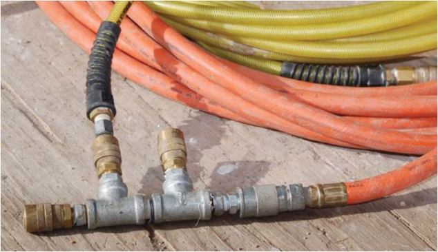

Because it takes very little frost to plug a 1/4-inch hose, I stick to larger sizes. I use 1/2-inch air lines for the main run from the compressor and 3/8-inch hose out to the tools.
It's normal for some moisture to collect in hoses and compressors. I drain my compressors daily, and about once a month I take my hoses to a warm, dry place (not a new basement) and hang them up to drain and dry. Vinyl air hoses are stiff and break easily in the cold. Rubber hoses stay more flexible but are heavy to drag around. For cold-weather use, I prefer polyurethane hoses because they're light and stay flexible to well below zero. My only complaint is that their flexibility makes them easier to tangle than other hoses. A number of companies make polyurethane hoses; I've had good luck with the Flexeel brand.

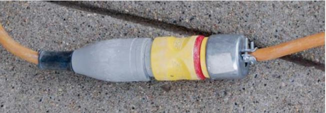

No knots. On my jobs, knotting electrical cords together is a big no-no because it stresses and cracks the insulation — especially in cold weather. Instead, we connect cords with locking plugs, which are available from a number of resellers including Acme Tools. I prefer the ones made by Qwik-Lok.

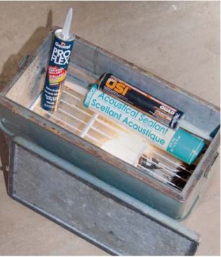

Some caulks and adhesives can be used in subfreezing temperatures, but they still have to be warm enough to flow out of the tube. We store tubes in a box heated by a light bulb. It's made from an old metal cooler and contains a wire rack to keep the tubes off the bulb.
